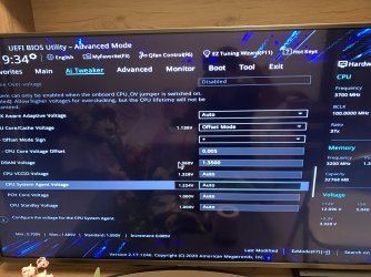

I begin to test with linpack because I bought some micron e die chips.
But what I don't get is huge vccio vccsa set by xmp for 3200 ram and the same problem on 10900k with 64gb 3600, 1.3-1.4v.
Jun 30, 2013
79 (0.02/day)
That seems to be the norm. Enabling the XMP profile makes the board raise certain voltages, namely VCCSA, VCCIO, and for Rocket Lake, also VCCIO 2. They can be set crazy high sometimes, which is not necessary at all though, unless you go way above DDR4-3600.
The board makers like to use a very high safety margin for those voltages, which just isn't needed. At DDR4-3600 and especially below, you can most likely set the same low standard voltages as it sets without XMP at DDR4-2133.
Do the following: Disable XMP, reboot, and if it uses DDR4-2133 frequency now, note the SA and IO voltages in the BIOS. Now set them manually to the values that are active. Here are my standard values with Rocket Lake for a lower RAM frequency, which i manually enforced for DDR4-3200:
By the way, you can press F12 to save a clean screenshot like this to a FAT32 USB Stick in the BIOS.
Note that i - for the time being - use a kit of older Kingston HyperX DDR4-3200 that only needs 1.2V DRAM Voltage to reach that frequency, albeit at looser timings than normal. I will soon use this as my main system and put my DDR4-3600 in there which will require the more common 1.35V for its XMP frequency.
Now it should still run like a charm, without elevated SA and IO voltages. You can do some RAM stress-testing now.
On my Z390 board, i'm even running at DDR4-3600 with stock SA and IO voltages. It just doesn't need more for stability. This is a good way to save a couple Watts.
