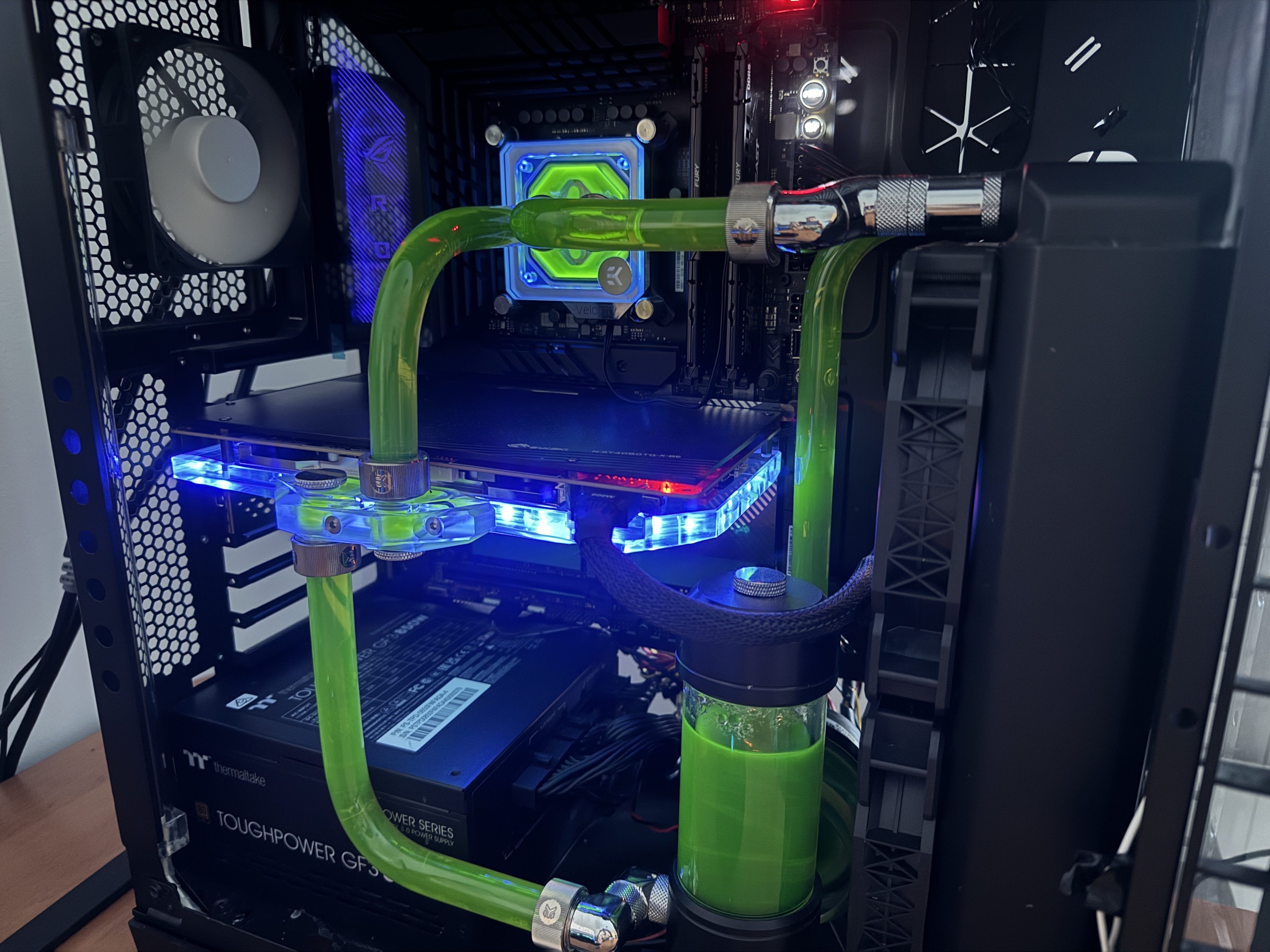

May 24, 2023
672 (1.91/day)
It is alive!
The old setup with 4070:
The wet GPU upgrade:
I let it run for a while with 250W GPU and 70W CPU load and the intake of the rad felt like 40°C, that is 20°C over ambient., that is probably not good.
Those are 280 rads, not 240. I think I probably should add another fans to the top rad and exchange fractal case fans from the front rad for P14 fans too.
It seems it will not be silent.... :(

May 24, 2023
672 (1.91/day)
I noticed something interesting about the CPU block: it is a new revision now, it has different internals. The old one fired water in the middle of the base slots. Now the new version has a different water jet assembly in it, which splits incoming water and fires it from both sides of the slots and it exits in the middle.
