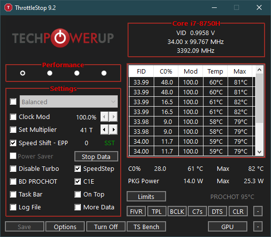

I have MSI GE73 RGB 8RF i7 8750H, GTX 1070 8Gb DDR5, RAM 16G
I undervolted my laptop as per settings shown below. At first, I set the PP0 value to 130 and I encountered freeze frames issue when playing Sniper Ghost Warrior Contracts. That issue occurred every 5 seconds when running the game. Game screen froze completely and then continued for 5 seconds then stopped again. But when I change the PP0 value from 130 to 200, all issues disappeared at once and the frame rate jumps from 50 fps to 120+ fps. Gaming experience is so smooth and CPU temp is at 73C.
I undervolted my laptop because CPU temp is 90+C whenever I'm in gaming. Now temp is around 73C and a smoother gaming experience resulted from ThrottleStop.
Is there any correlation between PP0 current limit setting and its effect on gaming? I'm happy if I learn something from that case. My settings are as below.

unclewebb
Jun 1, 2008
7,444 (1.28/day)
I have not heard of any correlation.
Some of your ThrottleStop settings might be the cause of your problems. Why did you set the turbo boost power limits so low? Your settings are half of what these CPUs are set to at default and about a third of what these CPUs need to obtain maximum performance. Setting the long power limit between 45W (default) and 60W is more appropriate. If your cooling is bad then try replacing the thermal paste.
Your core and cache voltages do not have to be set equally. Download Cinebench R20 or R23 and use that when setting your voltages. Run a baseline test with the core and cache both set to -125 mV. From here, start increasing only the core up to -150 mV, -175 mV, -200 mV, -225 mV. Each time run Cinebench again and you should see improved performance or improved temperatures. Before you do any testing, reset your turbo ratios to their default values, and set Speed Shift Max to 41. What sort of temperatures are you seeing during Cinebench testing? These CPUs are designed to run at over 90°C continuously when gaming. I think your settings are sacrificing too much performance when you really do not have to.

Thanks a lot for your reply! Now I will try like your say. My CPU temp is around 90C and sometimes goes up to 92C under full stress. I think I have to repaste CPU thermal compound too.
