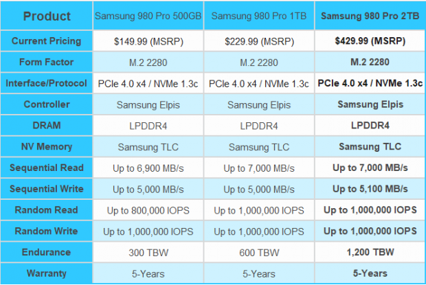

You're wrong. Looking at even the most basic of test i.e manufacturer specification show transfer speed and IOPS differences between two models of same drive 1/2tb.
Actual benchmarks show more details.
Care to post an example? I'm not seing that anywhere.
Samsung 980Pro & 970EVO /Sabrent Rocket & RocketQ / Crucial P1 and P5 all list indentical performance specs between the largest models and next size down which would make you wrong.
Samsung go as far as providing various IOPS specs too, and it's only the smallest models that suffer. The larger models saturate all channels on the controller at higher capacities.
An example of a difference between 1TB and 2TB variants is the Corsair MP400 but that's for the exact reasons I'm talking about - the 1TB model is the smallest, baby model in the range, and the 4TB and 8TB models are the ones that have enough NAND pacakges to fully use all of the controller channels.
