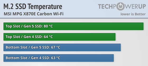

Is C° 80/60 is considered as excellent?
The 2nd 3rd 4th m.2 slots are literally under the GPU
If you start using the GPU too, those poor SSD will melt!

I have this exact motherboard.
This is at full GPU/CPU and SSD load (look at max values, third column). Probably an unlikely scenario to be using CPU, GPU and SSDs fully loaded in parallel, but this is what it is. With only CPU/GPU load, drives idle at 55-60C and roughly 5C less at full idle.
Corsair MP700 PRO (PCIe 5) is in M1 slot (between GPU and CPU), Lexars NM790 (PCIe 4) are in slots M3 and M4 (under the GPU) Not using M2 as it shares bandwidth.
Custom radiator may fit in M1 slot depending on CPU cooler used. My Arctic Freezer AIO extends over the motherboard's SSD radiator (it is quite chunky) so no large SSD coolers will fit there.
Hope this is useful.

63°C idle?
Those gen5 SSDs are really hot stuff!
63C was in a preheated system. typically around 50-55C in desktop tasks. Probably quite some room for improvement if I were to remove the labels of the SSDs and put better thermal pads on them, but as @_roman_ mentioned, that would trigger disassembly of GPU and/or AIO. At least assembling the system was a breeze. All tool-less.
