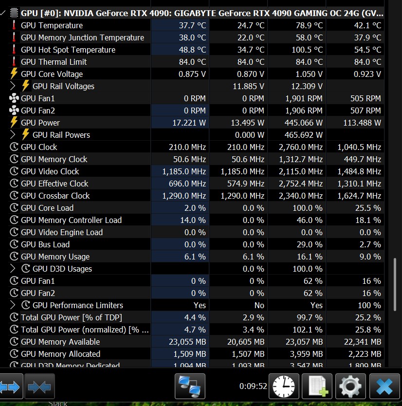

Joined so I could post this - there is DEFINITELY something wrong with MX-6 paste. I had repasted a Gigabyte Gaming OC 4090 November of 2023. Temps were great 60c GPU, 58C Memory junction, 69c Hotspot. After 1 year at roughly the same fan speed - temps were 79c, 58c, 101c. So pads were keeping memory the same temp still but GPU and Hotspot were way higher. Repasted and new pads...repasted with Noctua NT-H2...now GPU was at 62c, 60c, 70c. So basically about the same as the new MX-6...but 17c lower than old MX-6. Yikes.
attaching pictures of results:
Factory paste/pads left - Fresh MX-6 and Oddtone 12.8 W/mK pads right applied on 11/02/2023: (max values from benchmark highlighted)
60/58/69
Here's after about 1 year - note the memory junction temps (pads) were completely unchanged, versus the GPU/Hotspot temps taken 12/08/2024
79/58/101
Here's after removal and reapplication of paste and new pads - this time NT-H2 and using Arctic's TP-3 Pads. 12/09/2024
62/60/70
The Tube of NT-H2 I have is at least 2 years older than the MX-6 but it's shown no signs of age and on my other applications, no degradation. I did open a ticket up with Arctic and offered to send them my sample in but there doesn't appear to be any consistency issues with it coming out of the tube. By all accounts it LOOKS and applies fine. Its performance just doesn't last.
Chiming back in as I think my issue with MX-6 with my GPU was the less a problem with the paste degrading and more of an issue with pump out. I've been monitoring the NT-H2 that I applied temps are starting to creep up a little bit (3-4c higher than first tested). That got me thinking there's something more at play...I didn't realize the direct die nature of the GPUs causes the pump out effect until I read more from Igor's Lab.
I've decided to redo it again but use Thermal Grizzly's Phasesheet (PTM 7950).
