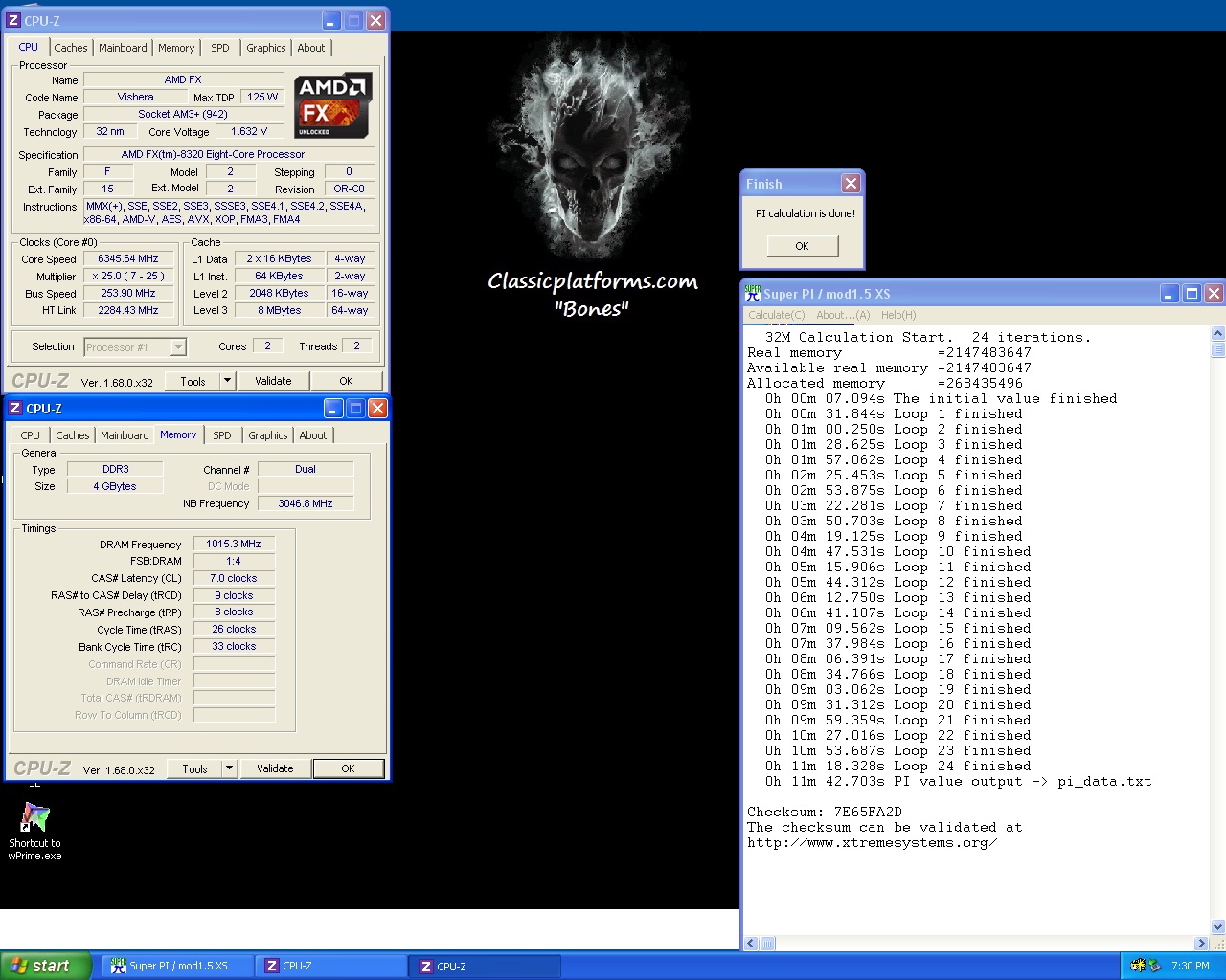

I'll throw this in as an example from a run I did sometime ago, these being a set of G. Skill PSC chipped sticks with a stock rating of CL6-8-6-24.
This example is a newer kit of DDR3 from Corsair, you can see what they are as indicated by the CPU-Z SPD tabs, rated as PC 2800 sticks.
For a set of G. Skill DDR3 PSC chipped sticks the 5th through 8th numbers of it's model string are "1040". If you see a set of DDR3 sticks from G. Skill with that on them, they are PSC chipped sticks and what you'd want to get.
I'll also say unless I "Know" what I'm seeing are the actual sticks I'm buying I'll pass on listings that say they have some but what you see may or may not be what you get....
