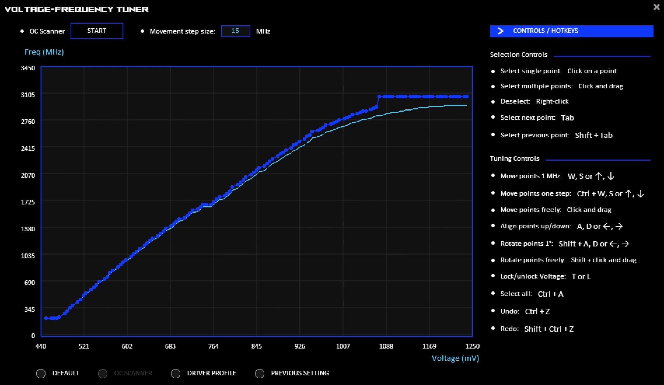

100% cannot see how a CPU OC killed your GPU. Another unrelated problem. Unless your saying it was a GPU OC, than still Cinebench isn't to blame, it would have happened anyways.
No, Cinebench was definitely to blame, and it was a gpu oc of ~+200mhz on the core, the maximum I thought stable since it didn't crash any other benchmark test (including Superposition and 3D Mark), but halfway (maybe less) through the gpu test in Cinebench 2024 my system froze/crashed and restarted.
After that I had graphical issues in every game I played, so it definitely was Cinebench that borked my gpu (RMA confirmed gpu had issues when I sent it in which didn't exist prior to the Cb24 gpu test w oc). Also Cb24 ran fine @ stock clocks.
This is roughly the curve I used, I set the boost to over 3ghz @ less than 1.1v and Cinebench 24 borked it. Try it yourself if you don't believe me, it would be entertaining to watch others suffer the same fate despite my warning.
Blaming software for a failed overclock is just silly.

Since I have both a CPU and a GPU OC, I'll be careful when I run Cinebench more. I guess I'll reset my GPU OC to its default settings while I run Cinebench. Thanks!

What was yours temperatures on CPU and VRM?How much Voltage you applied on your OC over the stock settings?
I wasn’t watching the temps at the exact time the crash happened, but my temperatures seemed fairly reasonable about 30 seconds before that during my test. They were all 80-90 degrees C. I’m honestly not sure how much voltage was applied since I just used the default PBO settings; it’s probably bad that I don’t know that lol. I do know it makes the frequency go from 3.8 to 5.1 GHz though. Thanks!
