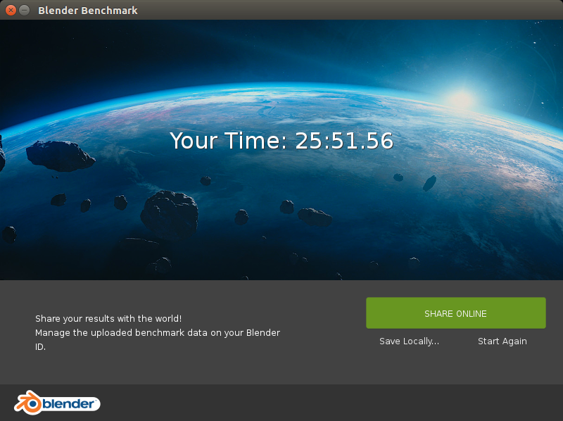

Blender benchmark:
The quick blender benchmark with GPU yields on my T5500 (GPU: GTX 960 (4Gb); CPU: xeon E5520, 2.27 Ghz; RAM :12 Gb; OS : Ubuntu 16.04):
More precisely, the render time for the different scenes is (second):
  • bmw27 : 414 s (1350.67 s cpu only)
  • classroom : 1137 s (3980.02 s cpu only)
I am curious of the results you would have. At first sight, the results of my GTX 960 are comparable to a 560 (in fact worst).
