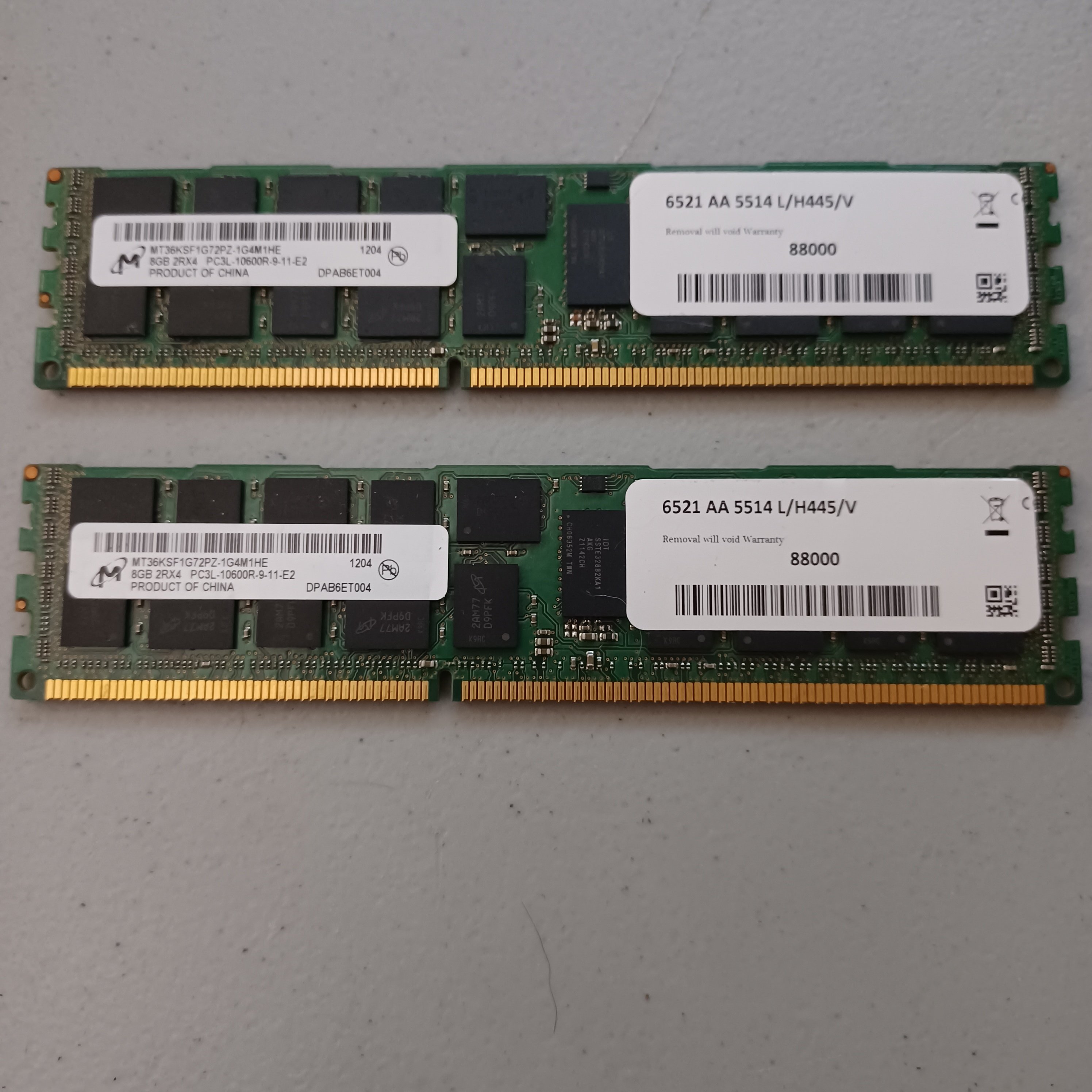

Well why don't you give a run down again of what you did and what you have. How many on what kind of memory, what cpu, any add on cards (needs to at least have a GPU) any drives connected. I'd like you to strip it to the cpu,1 stick of ram and the graphics card. Make sure that's how we proceed. I'm sure we can check voltages coming out of the psu if need be.
1.Tried Reseating CPU
2. Tried two different CPU's of the same kind (x5680's)
3. Tried fixing a pin that was spotted by a user here in CPU1's Socket
4. I do not have the riser card
5.Tried two different Ram (Will show in pictures I took)
6. Tried one Ram in DIMM1 Slot
7. Tried all Ram slots at once
8.Cleared CMOS
9.Replaced CMOS battery (When the computer booted once it told me low battery voltage so I thought about replacing)
10. Video card is a Radeon HD 2400 PRO (I like to use this when it comes to testing things like this, its a old card)
11.Replaced all brown capacitors (a user here told me that dell got in trouble for using these in these boards, I decided to change them to eliminate that factor)
12. There is one hard drive connected to SATA0 (The blue slot) The hard drive has windows 10 installed on it
13. Soaked/Cleaned the whole motherboard with 90% iso
Note: When the computer started up into windows just once it froze loading windows, (my older posts have pictures of when it booted) This happened once. after that it continued to be no display
Forgot to quote
Ok well let's take the boot drive out for now. It's not needed to get into bios which is all we're really concerned with right now. In other words nothing hooked up. You can yank your SATA cable going to your disk drive too. And I see you said you tried one stick in dimm1 and then populated all the slots? Try 2 different sticks 1 at a time in multiple slots. If you have a multimeter you can pin one of the sata power connectors for 5v and 12v. I know that's not all the rails but it's certainly easy to start. Other than that I believe that psu only puts out 12v and it's knocked down else where for 5v. Could probably back pin cpu and motherboard connector. Looks like you'll have limited time due to how fast it's kicking off.
I don't have a multimeter and don't know how to use one so that I can't do. I tried however sticking two ram sticks in two white ram slots and it showed the same issue/lights also tried the last white ram slot and same issue. Tried also all the black ram slots and it will tell me a beep code 1-3-1 and 1-3-2 which both relate to ram. even with no drive it still does the same, no display , no bios , no post
