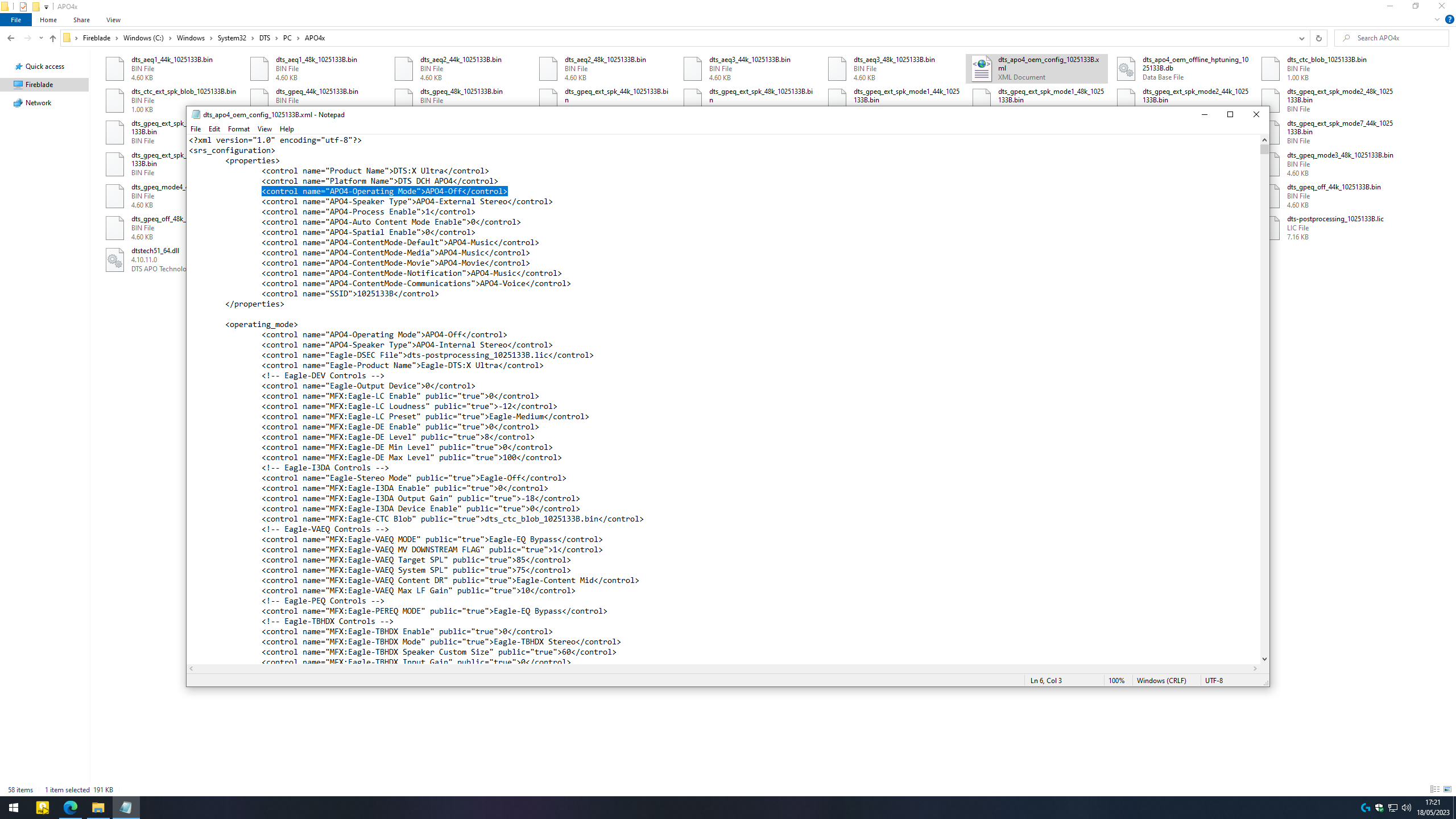

If you want to disable DTS FX processing without disabling enhancements in Windows, use the power button (Ultra app).
If you want to change the default mode (also used for multichannel) edit the DTS preset (example below).
> Go to 'C:\Windows\System32\DTS\PC\APO4x', and cut/paste the .xml file to your desktop.
> Edit the .xml (notepad), change 'APO4-Operating Mode', save, cut/paste back.
> Open 'Regedit' and go to 'Computer\HKEY_LOCAL_MACHINE\SOFTWARE\DTS\APO'.
> Delete all the endpoints but not the APO key, then restart the computer (x2).
You can do the same if you are making/tuning your own modes.
