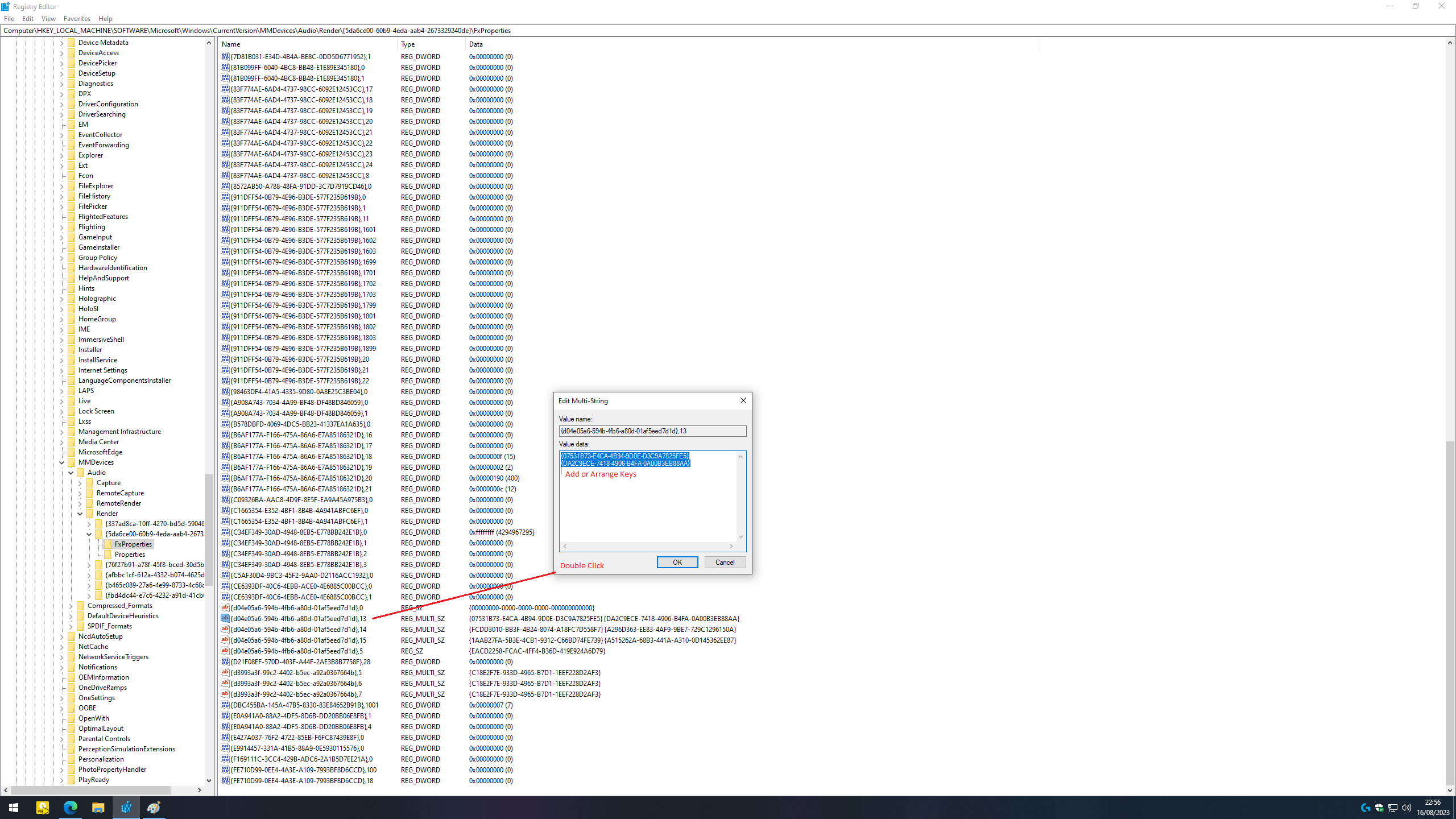

Ok I will go though steps with some explanation, so you can have both running. Multichannel will set the device to 5.1 and use the 5.1+ EFX, Multichannel Interactive is the same but for SPDIF only.
In your case you need only the HDA stereo file (which you did in your first post), Inside the SETUP folder in the' DTS Ultra' main folder, is FX with 'Class ID's.txt'.
Open the Class ID's.txt, and also FX Config, select your device, you will notice on composite is the 3 DTS keys, move the 3 DTS keys to the single SFX-MFX-EFX lines above the composite.
So now composite should be clear of any APO keys, and there should now only be 3 DTS keys in the single lines above, now run EAPO config, use original should now show.
Now you can setup EAPO to use SFX-MFX and also support the DTS single line keys you moved from composite to single line. EAPO does not support composite.

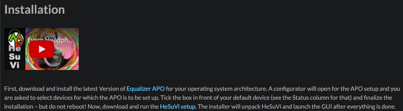

2. On this post (https://www.techpowerup.com/forums/threads/equaliser-apo-stereo-surround-upmixer.276608/) you said
Install Equaliser APO, when installing you will be asked which APO method to use, try 'SFX/MFX' first, then restart, then try 'SFX/EFX' using the configurator.
If you are using my DTS drivers, make sure you select 'SFX/MFX' and pre-mix only, no post-mix, and apply the reg file before restarting.

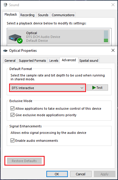

I also updated the package, it now includes Conexant and C-Media vendor id's, and the DTS SFX update change.
If you have a Realtek HDA device and DTS Interactive wont show, see 'Realtek HDA.txt', then restart.
If it still does not show, you need a supporting device policy (see here #1633).
DTS Interactive only applies to SPDIF-HDMI, not analogue.
You can also use my DTS Settings (from my DTS DCH pack), if you want DTS-Realtek HDA APO's.
I suggest you do 'Win CAudio' after uninstalling, before installing. Else disable all audio devices, apply, restart, enable.
The 'MSI Utility' (run as admin), can be used at anytime, tick supporting devices, apply, restart.
You only need to run these tools once, not every time you uninstall-install.

If you have to select DTS Interactive from the formats list after the restart, apply the edited .reg once again, this will fully set DTS as default.
If you prefer to work without FX Config, or it does not work for you for any reason, you can use ExecTI to run Regedit, and manually setup APO keys.
You can identify the correct device by selecting the 'Properties' key, then looking for the device name and other info.
HKEY_LOCAL_MACHINE\SOFTWARE\Microsoft\Windows\CurrentVersion\MMDevices\Audio\Render
You can do the same to edit then apply the setup .reg files, by copying the ID key.
I have attached 'Registry Keys.txt'.

Install (Double click) > Setup (reg files) > Restart | If SPDIF + DTS Interactive, select DTS from formats, then re-run the setup .reg.
