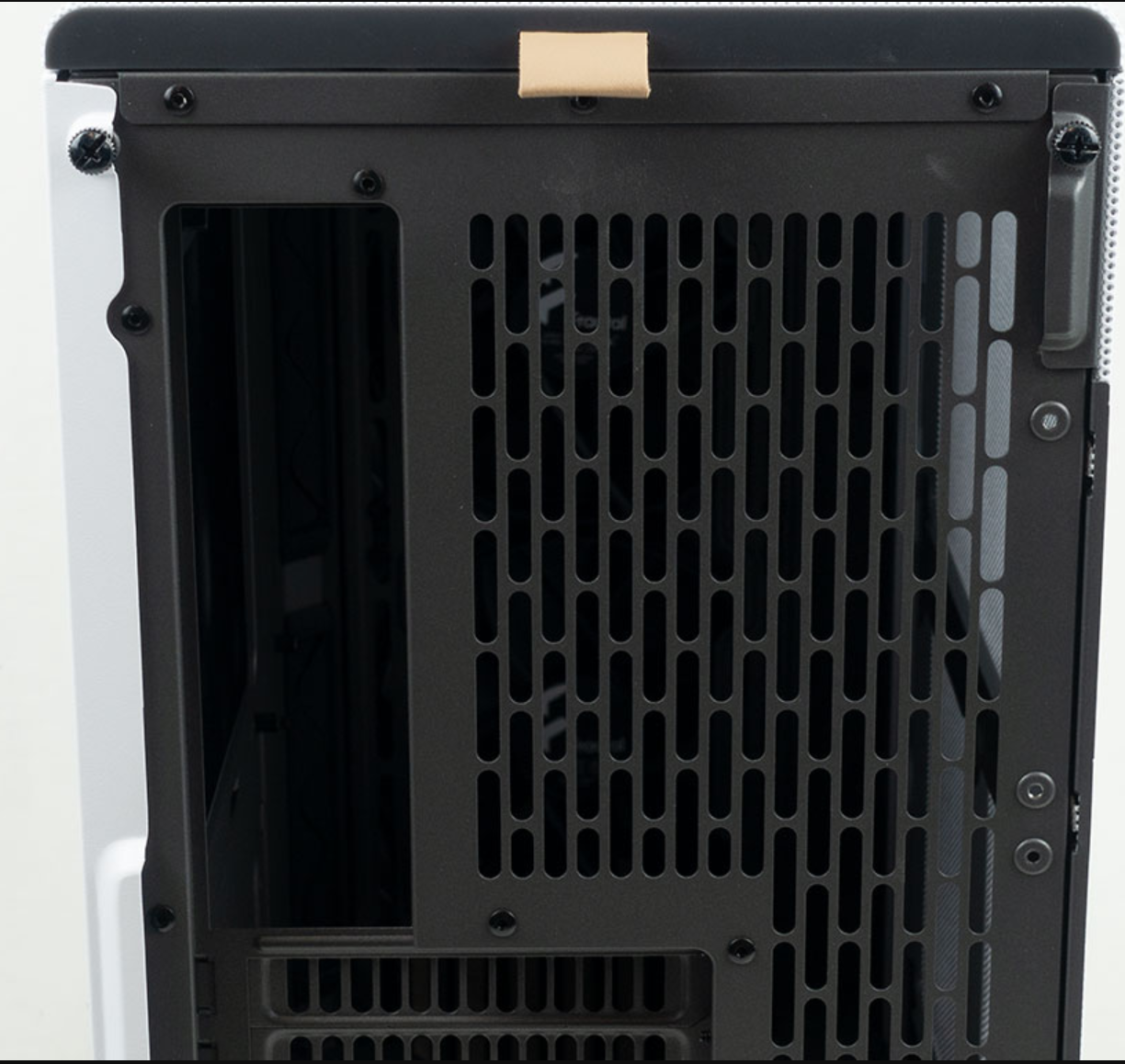

The open-rear design for pure intake on fans is smart in this form factor. Let the heat passively vent out, minimise dust and noise.
I can however see this going badly with a top mounted AIO as it's going to simply suck air in from the rear, and fill with dust in no time at all.
View attachment 273505View attachment 273506
There is ZERO chance that's getting air from anywhere but that unfiltered rear, since the side panel fans will feed the GPU and exhaust straight out (if they even fit, with modern GPU sizes)

Good point. I´ll see how I go about it when I finally pull the trigger, maybe could either block the top part completely or adapt some dust filter, I´d report back in that case. Thanks for the thoughts.
Gaffer tape is great for covering the gaps, as its heat resistant and doesnt melt away in summer, or leave nasty residues
Consider a dust filter for the rear, as well

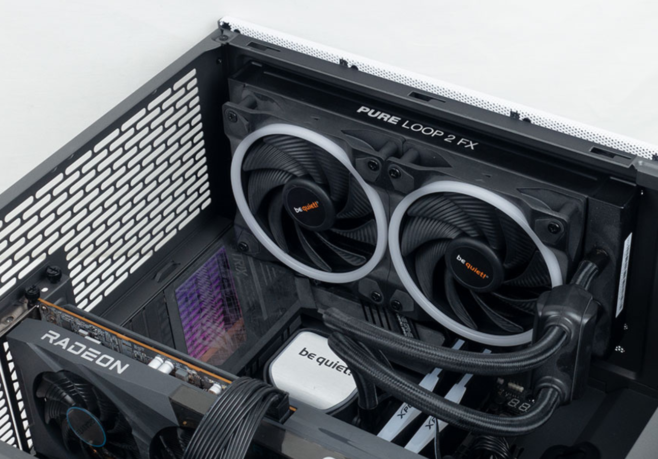

So I went ahead with the build and as promised here are some updates.
First of all 0 issues with RAM clearance, at least with my build I could have taken pretty much any height:
In case that helps other builders. Here you have full build BTW: link
Regarding airflow, thanks again @Mussels for your thoughts on this. At constant high settings (front and radiator fans at 80%) the flow seems to be in the "right" direction, but this is a very primitive test for now (just put a long stripe of thin paper from inside and outside and a flashlight inside the case):
The radiator fans definitely have the power to suck air from the rear in any case, for example on start-up, when there is no airflow yet, they almost sucked the piece of paper through :oops: ) I think I´ll put a filter on the top part of the rear grill to be safe anyway... but seems it´s not a big deal so far (almost fans run a lot lower most of the time, pretty good airflow). I´ll do some proper airflow testing with incense or something when I set that up. EDIT: could also put a exhaust fan in the rear of the case...
Hope it helps someone and thanks again for the comments.
The RAM height is an issue with an AIO or radiator, since they come down into the space of the RAM
radiators can come in thicknesses of 15-45mm, and then fans vary from 15 to 30mm
Some slim setups will fit just fine, but it's something you absolutely need to know about

Absolutely.
To underline the build and the photo is with an AIO with the radiator on top (DeepCool LT520 with the standard fans in push configuration). I included the link to the detailed build because I am aware it can be specific to the choice of components, but in this specific case any height would have fit, and thought it can be good to know for others as long as they are aware of the caveat.
