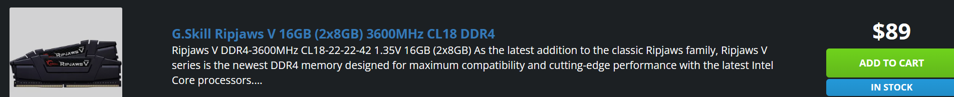

I'll speak of DDR4 since i'm more familiar with it, but why fight for DDR4 3800/4000 in two ranks, when you can get four ranks at 3200 and have it work out of the box? (or 3600 with minimal effort)
(In DDR5 there are these same points of diminishing returns, i just don't know them off the top of my head)
Would you rather:
32GB of 3600 for $178
Or 32GB of 3600 for $155, condensed into two sticks, with the option of 64GB in the future
2x32 kits start at $320 but have no direct comparison at the store i'm using
If all you wanted was 3600 for that compatibility and ease of getting it working, it's downright a bad idea to get 2x8 paying more for less performance and less upgrade potential
The fastest 2x8 SR kits they have cost as much or more than 32GB DR, and outside of very small latency gains you're not going to get any benefits from doing so - and four of those 4000 sticks sure wont run any faster than four 3600 sticks
