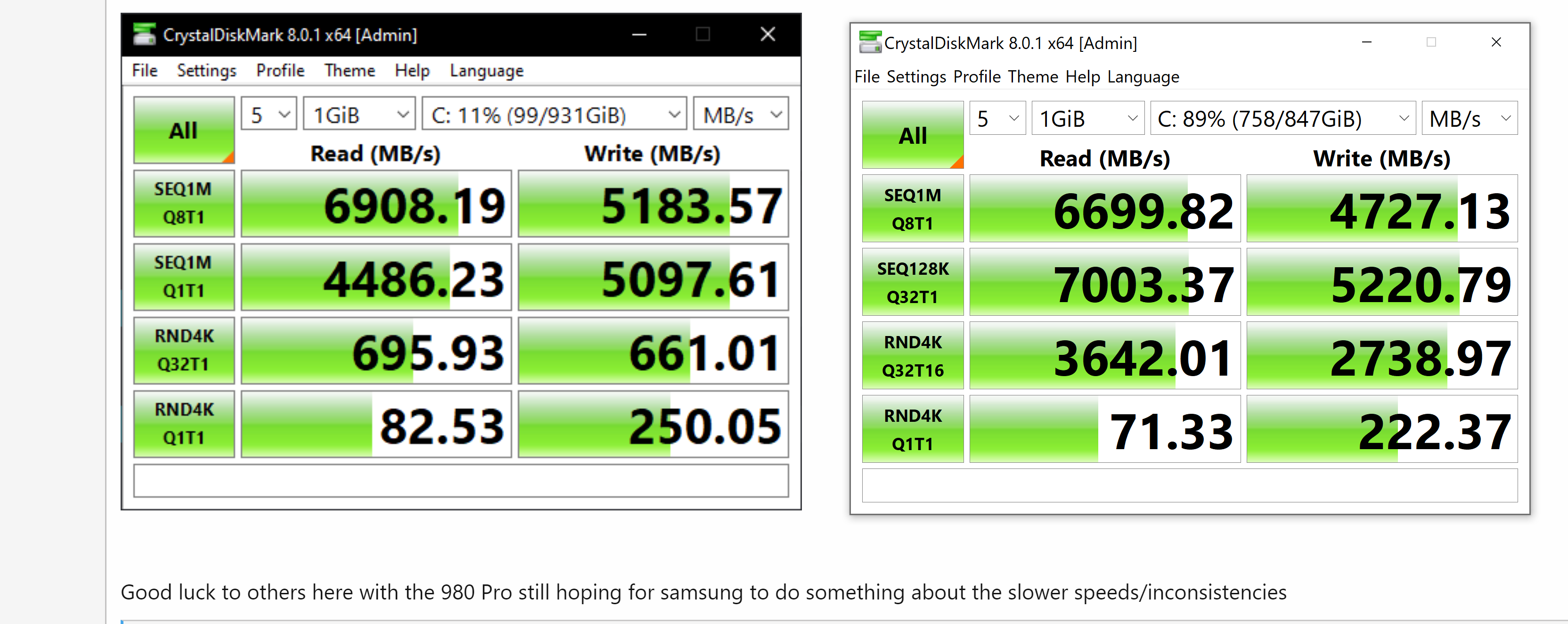

Returned 980 Pro and grabbed a WD SN850 1TB and a heatsink to go with it because I read about hotter temps ... @Pwablo thanks for the tip. Much better. Moving on from 980 Pro, farewell!
WD SN850 Speeds are definitely much more consistent.
Good luck to others here with the 980 Pro still hoping for samsung to do something about the slower speeds/inconsistencies

I've been following this thread since the beginning. I blindly bought a 980 Pro after assuming they were still the "best".
You can imagine my disappointment when I came across the slow speeds.
After trying what many on this thread tried with no real improvements I decided to set up an exchange for the SN850.
However I recently updated my Chipset drivers (latest for X570) and here are my speeds now (I've screenshooted next to @kvnkim who posted their SN850 results: My benchmark is on the right.
As you can see I've not done any trickery like benchmark a drive that's nearly empty or anything, my drive is actually nearly full lol.
So I'm now considering cancelling the exchange for the Sn850 as to be honest it's a massive inconvenience having to re-install windows and download my games again.
For anyone with issues, maybe try installing the latest chipset drivers, AMD released some this month.
If anyone is wondering why my drive shows only 847gb I've enabled over-provisioning in Samsung Magician

Well folks, I would like to think that Samsung have taken on board all of the issues that users have been experiencing with the 980 Pro, as they have just released a firmware update for it. I have not installed it yet, but hopefully this is the fix for the write speed issues we have been waiting for.
Unfortunately that firmware has changed nothing.
The performance we are seeing is normal.
It's been picked up by recent reviews, even tech power up have a section on it https://www.techpowerup.com/review/samsung-980-pro-1-tb-ssd/6.html
Essentially when the cache get's full "TurboWrite" stops and we are left with slower speeds. Samsung state:
The sequential write performances after Intelligent TurboWrite region are: up to 500MB/s(250GB), 1,000MB/s(500GB) and 2,000MB/s(1TB and 2TB).
Which is inline with what we are seeing.
EVERY single TLC NVMe has the same issue, however drives like the SN850 have a larger cache and faster speeds in other areas.
Samsung just haven't been transparent about this, it's great focusing on peak speeds but the reality is no 980 pro owner will see them 90% of the time.
One thing that is interesting is that normally NVMe drives get slower as they fill up right? Well the 980 Pro get's faster and has the fastest sustained write speed when nearly full.
