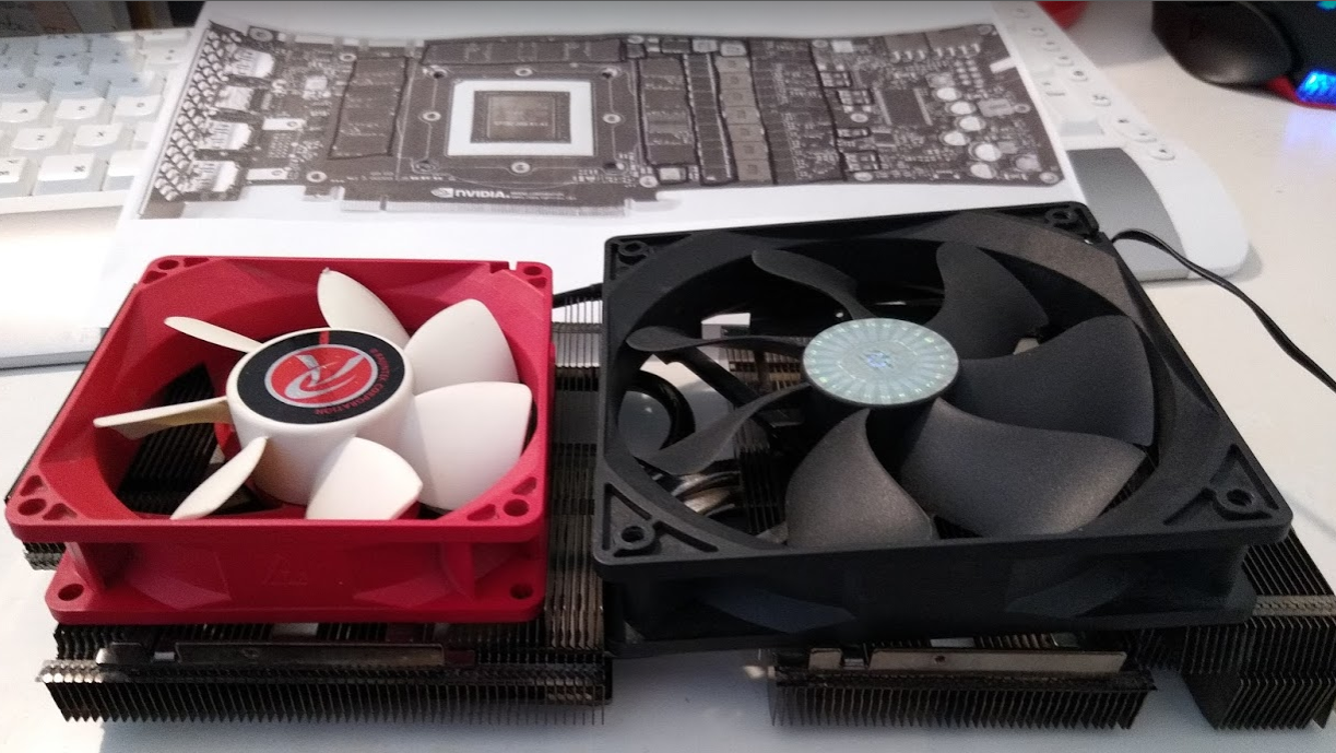

Hellooo TPUers and Ghetto Mod Peeps, Well i have a little project that i thought id share with you guys and gals.
My best mate sent me his 1080Ti FE the other day and although its a great card an all , it doesn't like overclocking and even a small boost sends the fan in hyper space!
I've already had my compressor blow all the shit out of it and put new MX4 on it, and that took it down 3-4 degrees @ idle and it does boost better but it is noisy still when on boost.
So I was looking at aftermarket stuff and really cant afford a 70euro cooler(artic and rajintek) also i don't want to loose my aio from my 4770K(was thinking of a G12 kraken)
So i pulled up some pictures of after market oem coolers and realized that they isn't much difference from my ACXcooler on my 780ti classy.
I am waiting on some parts( mini 4pin fan header to twin 4pin pwm adapter)
I am going to attach a 92mm and a 120mm from my stock bin to the acx cooler as below(zip ties prolly)
I have had both fans running and there is a lot of air moving at the back/underside of the cooler (I wet my hand to test for moving/cold air)
I've got a good impression what will need to be modified/taken off the cooler(rear caps, pcie connectors/4 pin fan are in the way and one of the bottom choke assembly)
Areas marked in black are parts needing cooling, red are obstructing and yellow seem ok for clearance.

Little update
After fettling with the cooler and fans, I'm super chuffed that the 120 fan actually fits in the bracket that the ACX fan casing was attached to and happy to have it blowing on a slight angle,
really pleased with the minimalist approach of connecting the fans to the cooler (2 zips for the 92 and 1 zip(2 connected) for the 120 with the wire holding it in place at the top.
-The 120 fan had the worlds longest fan wire and the holes were really tight for the zip ties to go through and as such its held into the frame by magic :)
I'm really pleased with cable management/routing it has a zen like understated look.:roll:
I dont have a dremel so used the age old method of bending back and forth the fins till they snapped off, the first few i tried a pair of Snap On side cuts but bending left a better "cut".
There was a slight mistake on the post above, the power for the fan i had mislabeled, that was the power for LED GTX logo, I have remedied that and taken out the required fins for both, they should both fit now.

I tried this a while ago with a 7970 and was sorely dissapointed :( Temps went way up from stock. Though I didn't use the best fans, I went from a single small fan to 2x 90mm ones and I ended up having to go back to stock.
Thanks for your comment, i am quite willing to go back to stock if this doesnt work.
You didnt mention which cooler you tried to replace the blower with?
I have studied the ICX version with my ACX version and tbf there isnt a huge difference(both 6 large heatpipes and covered die area) I would of liked better spacing of the heatpipes so air can get through better but it is what it is.
ICX 1080Ti
ACX 780Ti
also im fitting a 120 and a 92 which is quite a step up from 2 x90, either way it is all in the name of science and fun! :toast:

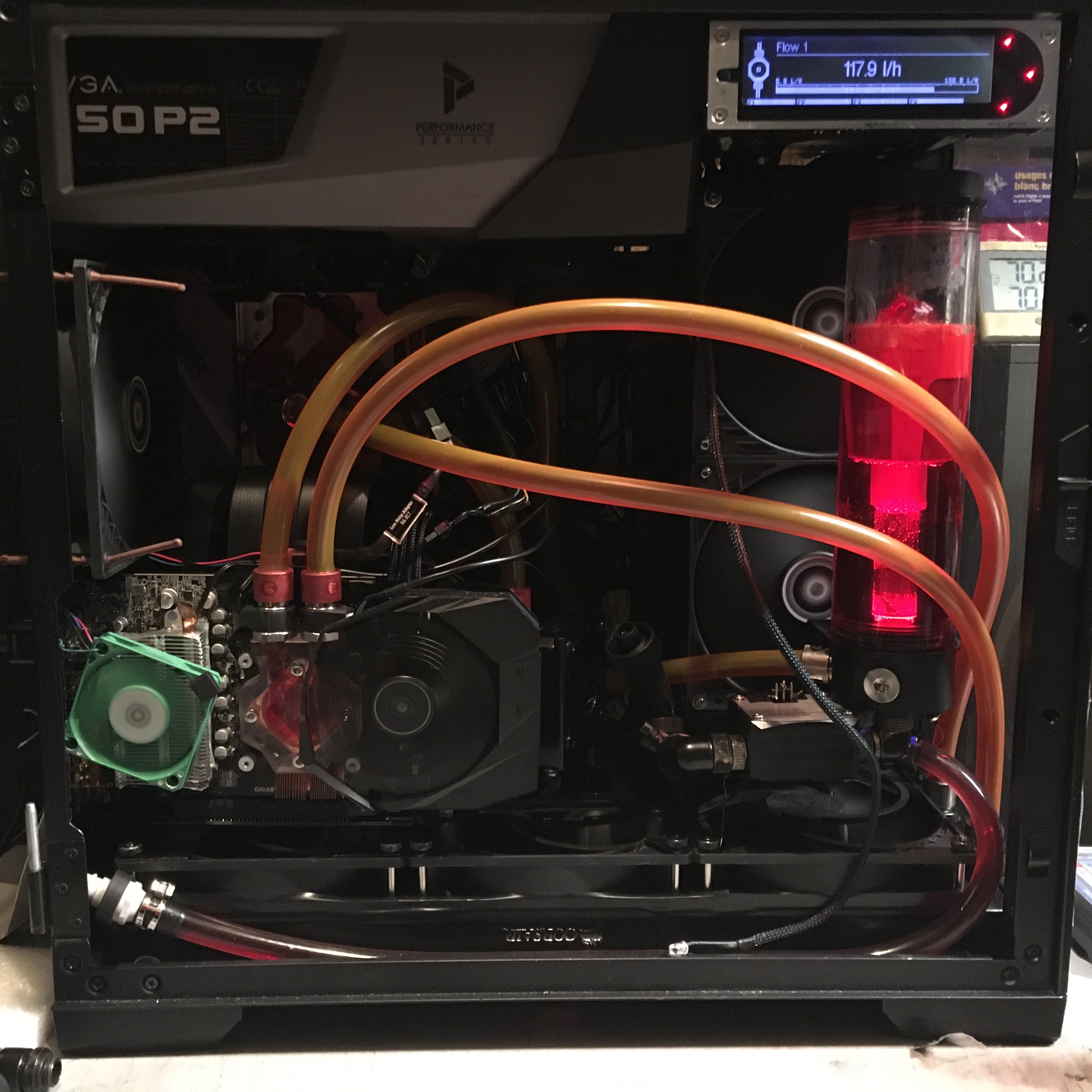

gtx1660ti, watercooled via amazon “special” cooling block (pomya GPU Waterblock)
had to cool the vrms so “hacked” the heatsink to fit (did not need the gpu part) used an original AMD heatsink fan... probably from the first amd processor i bought.
...chopped the GPU fan to half length...
the reservoir water filter has a Keurig coffee machine reusable coffee pod filter with lid removed drilled the bottom to fit eisbecher 250mm center tube. held in place with 13/19 tubing over the center tube sanded down to 13mm diameter...
the fountain output is a 10/13 piece of tubing in a 13/19 section to extend the center tube.
the coffee filter is a water filter and a bubble/vortex stopper...
the reservoir is lit by a cree 5050-16 led, and LED driver with the aquaero fan channel in voltage mode... (may change to the lm2596 cc circuit and 12v output... ) if you look closely, it looks purple... because i knocked off the lens of the led installing it into the bottom of the 5mm clear stopper fitting...

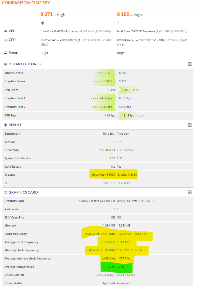

Quick update---It works!
We are around 8 °C cooler on idle (now) 17°C -- V -- 25°C(FE cooler)
Im playing with the fan curve atm, but its seeming we have have hit round a -25°C+ differential
So i will say atm its a treble win for me, cooler, quieter and a better OC.
VIVA la Ghetto!
Photos to come if your all interested :)
