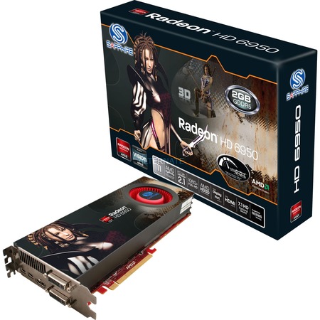

Hi,
Does anyone have a reference design Sapphire HD6950 2GB with a red PCB?
I want to order this card, but I'm wondering if it has the BIOS switch.
Thanks in advance ;)

Hi,
http://www.alternate.be/pix/prodpic/450x450/j/jdxsw1.jpg
I just ordered another one off Newegg. In the 5th picture, it has a view of the power connectors and crossfire bridges. Zooming in will show you the bios switch, so if it has that picture wherever you are purchasing, try that...it should be there if it's in the pic (that's what I went by). Hopefully its there when I receive it.

Well... the thing is that on newegg it's a black PCB card, but at my local store it's a red one, that's why I'm confused :<

You could always buy it, open it, and check to see if the switch is there. If not, take it right back and order from another place. Or you could ask the people that work there, as long as its not some place that hosts incompetent-idiot staff like Best Buy.

The ones on new egg are the rev2 with no extra shader for the sapphire ones. Check the model number before ordering.
