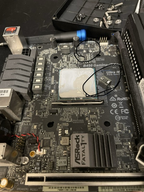

I decided to superglue my motherboard inductors as suggested here. Please give advice on how best to do this for the motherboard? Is it more profitable to remove the heatsinks from the VRM or the cooler (BeQuiet Dark Rock Pro 4) from the processor? Do I need to somehow protect the VRM transistors from getting superglue on them, because if you do not remove the VRM heatsinks, they can stick, and if you remove them, the glue can prevent you from putting them back. In any case, when the VRM is heated, the adhesive may stink. Although my motherboard model is cold, only the processor is hot, its temperature in AIDA64 is up to 89 degrees.
Should the adhesive be poured from the socket side or from the VRM side or between the coils? Also does anyone know how thick the thermal pad of this motherboard is so I can buy it in advance?

thermal pad can be reuse if not too much damage.
I would suggest identify which part is making sound. Then use a toilet paper roll to check which coil making sound.

Replacing the coil is a very time-consuming operation that requires tools. Fixing it with superglue is much easier. I plan to apply superglue today, it should dry by tomorrow. Perhaps I'll try to protect the VRM with cling film.

You do not glue the top of these devices - you're glueing the gap between them and the motherboard so it soaks inside them.
I don't think you should be gluing that board, see the PSU Comments below.
An important question here is, what PSU's did you actually use? You partially named one - and that's an old PSU from 2016 - no wonder it has issues with a modern setup, it's going to have aged and it's likely not designed for modern hardware with such low idle wattages and such fast transitions between load and idle.
You can possibly fix your low idle wattage squealing by disabling C-states in the BIOS and adjusting the PSU idle control setting

Thanks, but I don't think the problem is with the power supply. The power supply is ATX 12v2.4, and the motherboard was created when ATX 12v3.0 was not yet created. On the Fractal design ion + 2 power supply with ATX 12v2.52, the same problem.
I glued the induction coils and I didn't use cling film because I figured out in time that it would cause the superglue to spread all over the VRM. However, due to a moment of inexperience, some superglue did get on the VRM chips. What can be done to clean them now?

A good simplified way to explain the noise issues is how PWM fans work, or a modified sine wave vs simulated
The power is pulsed, and those pulses are timed. Having too much amps arrive early or late results in the voltages rippling up or down, as the phases turn on/off to adjust for the changes in power demand.
remember that they're pulsing it to match changes in demand.
Depending on where in the setup you're at, power could be coming in or out as either side of this image - being converted from one the other.
multiple phases are used so the square setups compensate for each other, so the steps are smaller - but they can go out of phase (hah) with each other too, if the incoming voltages are different between them.
You'll notice it's the current that varies here, not the voltage.
They use multiple phases and try to time them to provide as smooth a curve as possible, but when power consumption (current/amps) goes above or below the happy range for the components or voltages are higher or lower than expected - you get noise like a squeaking door as they're forcing themselves to shut against a strong flowing current
Actually, closing a door and having air whistling past is also a great example of how to explain this.
Low voltage with a higher current, the door/gates have trouble opening, while high voltage and low current you get sqeal as some of the current sneaks past after its meant to be closed.
The timings being off results in the square looking output, and voltage ripples. Capacitors can smooth it out again, but only so much.
On the CPU and mobo side, definitely look into altering how the system idles - even something as simple as the high performance power plan in windows could have an effect there, as it definitely did back on the x58-UD3 gigabyte boards back in the day where low idle wattages resulted in single core CPU usage being audible over the onboard audio as you moved a USB mouse around.
For GPU's we're a bit more limited, as we can only try changing cabling to reduce resistance (smoother/higher voltage inputs), or altering clock speeds and voltages up or down to get them out of whatever unhappy state they're in, without physical modifications
What frequencies are we talking about here? as those outside the audible may be of less issue; modulation from the video card may be the problem.
So while it's small, you definitely noticed a change from the capacitor cables?
That's not something i can answer - I've been learning as we go in this thread, and much of the information comes as second-hand snippets from more experienced people who don't give full explanations.
(Jonny gurus self-deleted posts, YT videos of people replacing capacitors on GPU's without explaining why they used the ones they did and accidentally fixing their whine, etc)
I aint graduated from homeschool e-lec-trici-tah 101 yet, a lot of what i've put here has been guesswork that i've googled to find out how accurate the guesses were and slowly we got a few hits.
Some of what i wrote recently has been after using a modified sine wave inverter and hearing the fun noises from devices that didn't like the way they produce the power - they really had a lot in common with the coil whine we get, at a lower speed.
Same with over-using a 24v to 12v step down converter, once it reaches its amperage limit it whines, and my solar MPPT controller develops a high speed clicking when it rapidly goes on/off as the sun sets, where it's voltage and the battery voltage meet. JG mentioned that as a problem in his quotes as something people mistake for whine because it's rapid, but the tone is totally different.
(The clicking is from when voltages drop too low, specifically)
I'm pretty sure a big part of the noise is the common, the ground. Anything that keeps the voltages even on all the rails and the grounds even, prevents a lot of noise.
When a design has paired up components, they're not expecting any variances in power - but it can happen when they've got two sets of power cables with 3-4 pairs of power+grounds, with potentially different resistance due to cable damage, bends, etc.
I assume those capacitors help that in some way, by smoothing out some spikes in the power, and keeping things even between whatever rails they're bridging.
