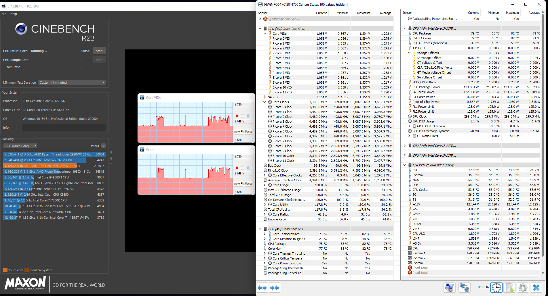

I don't normally use Windows but I have it on a different SSD. So I had to reboot into it.
My CPU is moderately undervolted below its built-in (i.e. "fused") voltage-frequency curve.
Note how in my case under load VID = Vcore and thus power measurements should be about correct, since I correctly configured the DC Loadline parameter in BIOS.
12700K 75W (16568 pts):
12700K 125W (21501 pts):
So, you are proving my point. There is something gone horribly wrong with the review....
