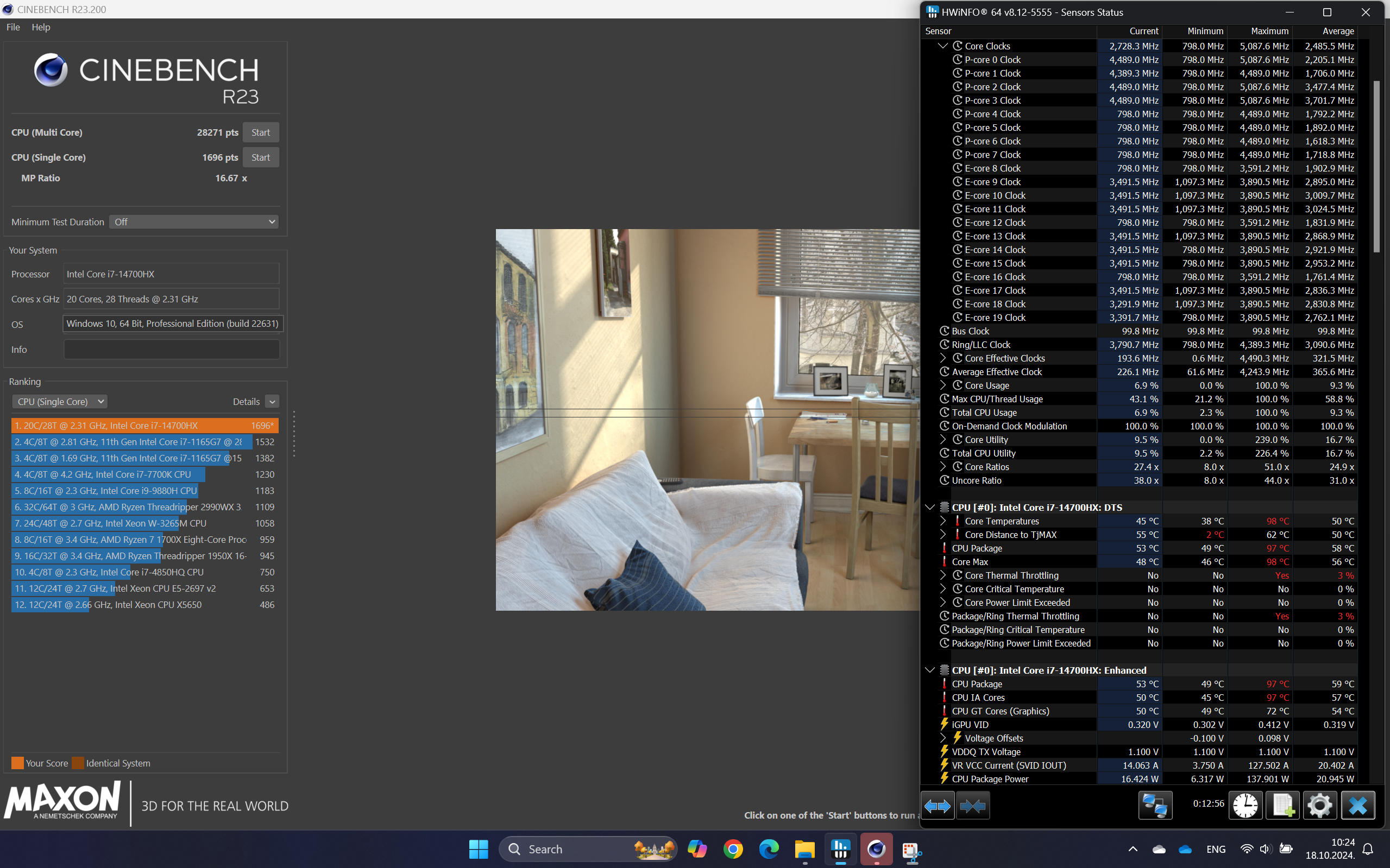

Hi all, I have some issues here with a new Legion 7i 14700HX with 4060 laptop as you can see...I'm following some yt tutorials relate to ThrottleStop and undervolting, but whatever I do, my offset values are always +0.000. (picture below). Fivr is not protected, cpu overclock enabled in bios. Bios ver: NSCN32WW. Any ideas...thanks!

Exit ThrottleStop. Delete the ThrottleStop.INI configuration file. Turn off your computer. Start back up and try again.
If you still have problems, run msinfo and check if virtualization is enabled. Post a screenshot of the Windows Features window.

I did all you tell and after lot of pain it finally works all. First although Hyper-V was turned off in windows on all places, from some reasson, virtualisation turned back to on in Bios, after disabling it again (all on pictures), ThrottleStop finally started to show propper offset values...but from some reasson, all cpu cores worked fixed on 399mhz all the time. After multiple resets and deliting ini for throttlestop, everything seems to work (except I'm getting low single sore values in R23). But after all, before the best multy for cinebench was 25k and with `160W on cpu power package, now I'm getting something below 29K and with 138W; great improvement. Now I just need to find some tutorial on How to start throttlestop with windows and to check what happens with that single core performance.
Edit: I'm seeing online that 14700HX should have `2100 pionts in Single Core R23?!...Help

Your Windows Features list shows that Virtual Machine Platform is checked. I am not sure if that is OK or not. It might be OK after disabling virtualization in the BIOS. I would still disable Virtual Machine Platform in the Windows Features list just to make sure.
The biggest problem I see is that IccMax is set to only 1.00 Amp. That can cause constant EDP throttling. I am not sure what the default value for your CPU is. Did you follow my previous directions exactly?
Usually when you power off your computer, the BIOS will reset the IccMax value. When you start back up, if the ThrottleStop.INI configuration file has been previously deleted, ThrottleStop will read the default IccMax value from the CPU. I do not know why this is set to only 1.00 Amp. That could be a problem with your BIOS or for some unknown reason this did not get properly reset.
I would recommend trying to reset your computer one more time. Follow my advice exactly. No cheating. When you power down, pull the plug out of the wall socket and wait 10 seconds just to make sure that the CPU has been reset. When you run ThrottleStop after doing this, it should show the default value for IccMax in the FIVR window. The default value for both the core and the cache is usually around 240. I prefer setting IccMax to the max for both the core and the cache but that seems to scare some people. All I know is that setting IccMax to at least 240 is a lot better than IccMax being set to only 1.00.
Exit HWiNFO when testing. Show me a screenshot of ThrottleStop with Limit Reasons open while Cinebench is running in the background.
Man thanks a lot, you learned me a really valuable lession!
Yesterday I played a bit with system, I saw that there is some conflict between Lenovo Vantage and ThrottleStop. Basically from some reasson cpu core 4 (single core test use it), didn't go over 44x or 4.400mhz. After deleting .ini this time, resseting bios values as you said, all on default and in warm room (I have 4 months old baby) I got 2000+ witouth problem. Also I'm not loosing my nerves anymore seeing a 100 degrees in HW monitor, now is 97max again. I'm old scool and I miss old days when you got a lower temperatures with higher undervolt...now I have only more room for frequencies. I'll play more with all of this when I find time.
Thanks, thanks, thanks!

Glad to see that your Cinebench score is back to normal.
