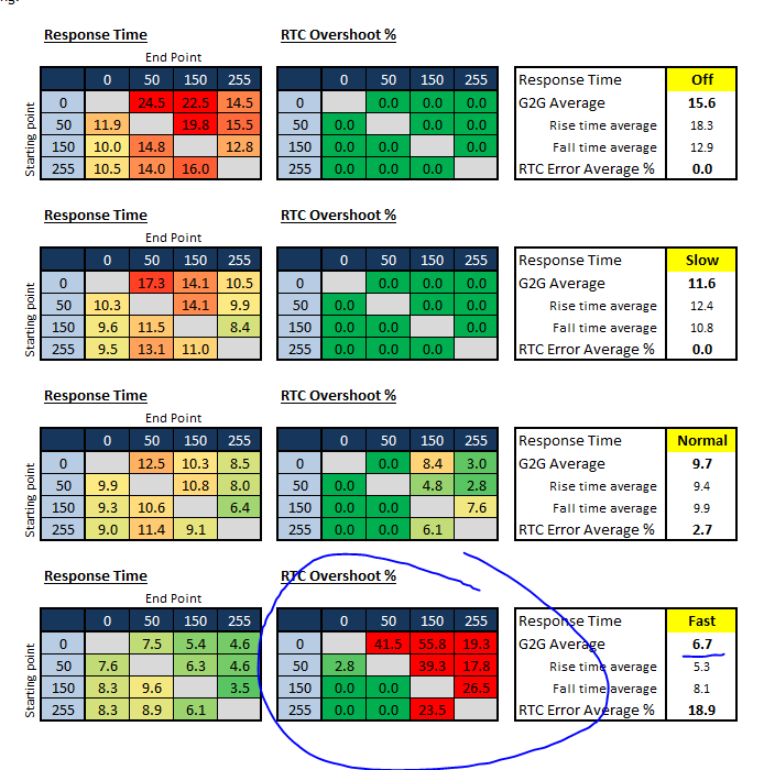

The point is that IPS panel specs dó tell you whether you're dealing with faster or slower panels. And also that the 1ms TN claim isn't complete nonsense - the best case G2G for TN is indeed very close to 1ms (it shows 1.3ms in some situations above).
When an IPS panel says 5, 6 or 7ms, you can rest assured its a slow one. When it says 4ms, its a faster one, and the difference is quite significant.
I remember seeing monitors with 1 or 2 ms advertised when they had something like 7 or 8ms. What i'm saying is that the advertised response time is often the minimum measurements, and not the average, while the average falls kinda far from the minimum
Correct, but those are exceptions, if you get the manufacturers original spec list for each monitor, they will indeed all show a best case G2G (no exception) but relative to one another, they still signify that they're slower or faster overall. That is why I showed you those examples. Its not complete BS.

5ms GTG= no go
What's your beef with 5ms? 5ms is good for up to 200Hz.
nano-IPS is built different than regular info. i saw the engineering designs on it. it might eliminate IPS glow, we really don't know yet, there is only one monitor in the wild with it so far and its a 34" 21:9 so not fair to even look at that one imo because so large.
i'm very curious to see what this 27" model looks like as long as the price is right.
Here's a "5ms" high refresh rate panel from LG. 144hz at that... Its a ghosting fiesta
http://www.tftcentral.co.uk/reviews/lg_34uc79g.htm
Oh, that. That's a 10ms panel at best, judging by the response times. But as long manufacturers are allowed to slap a 5ms sticker on those, the complaint is legitimate.
