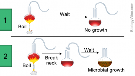

Unless it is dropped first.
There was an experiment by Pasteur to show bacteria exist. He heated soup but left it connected to the air by a curved tube; the bacteria collected at the bottom of the curve and the soup did not go bad.
OK, this is getting a bit crazy; the only point I am making is that the slower the flow the less dust is suspended.
I wonder if one could make a cyclone dust trap based on this principle (a bit like a Dyson vacuum cleaner).
Amazon.com: Cyclone Dust Collector Dust Collection Dust Separator Shop Vac Accessories (Green) : Tools & Home Improvement
Ah, the OP is not interested in dust entrapment; I stop.
