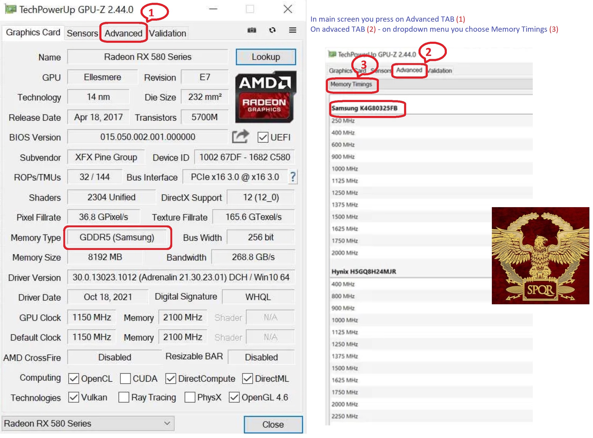

In order to find an exact match for your card, we need more pictures.
One from GPU-z main screen
One picture from GPU-z > Advanced tab and from drop down menu you must choose memory info.
Thanks a lot for your quick answer,
This are my screenshots
Regards from Colombia.
Well, i checked TPU db and indeed you are right.
The BIOS you have right now in your card is identical to the one in db.
That BIOS was checked by admins.
On the other hand i have a question : why you need to flash the card?
If your card is working as it should, then you have no reason to "update" your BIOS.
Unlike motherboards, the video cards don't need the BIOS to be updated.
So keep it as it is now cause you have the right BIOS in it.
Cheers
