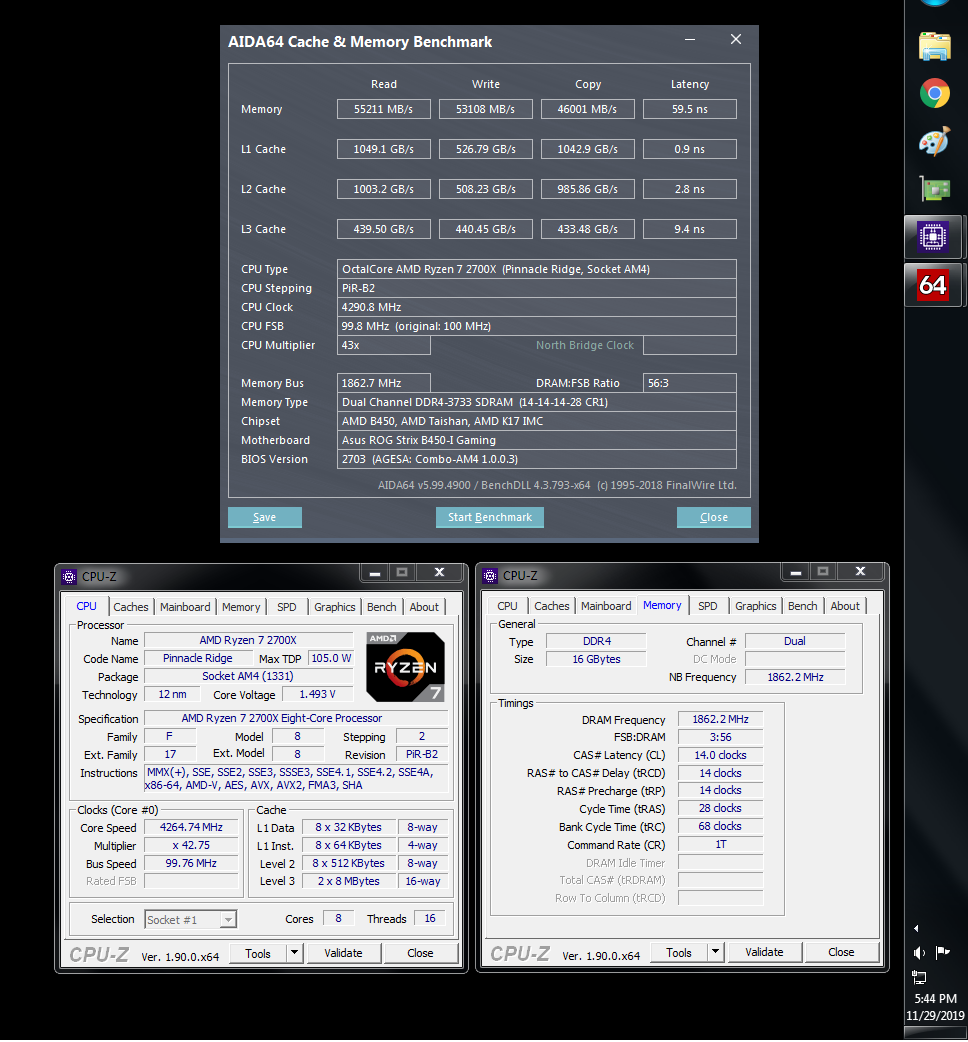

Those are 2 sets of settings, 1 safe and 1 fast to test. I would test the fast 1st but if not stable go for the safe one. Zen+ aren't easy to go beyond 3466 without much trial and error efforts.
My 2600X couldnt get over 2667mhz 4 dimms used.
You said it yourself. 4 dimms used. With 2 dimms it should be able to run at 3466MHz.
