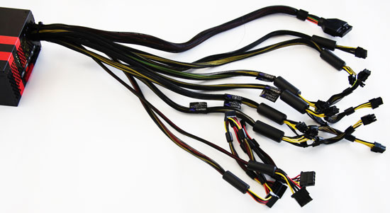

Power supplies in-cable capacitors, why people dislike them ?
don't talk bad about my Powercache in antec tpq 1200 quattro
View attachment 153117 View attachment 153118

Resistance plays a role in how capacitance and inductance affects a circuit. And cable length affects resistance. So the location of the caps on a quality cable may not matter significantly, but it could affect the value of the caps needed. I note some PSU makers put the caps in the middle of the cables because they simply look better there. The caps don't get in the way of the connectors and can be hidden away more easily.

It is always recommended to use the cables that came with your power supplies. I'v read threads of people damaging their power supplies by using third party cables, some PSU's even have a warning on them to only use the cables that came with the unit itself.
Sorry for my part in the nonsense, SSS.
In reading back through this thread, I noticed no one replied to your comments about swapping cables.
Part of the problem with using 3rd party cables, or cables that came with different PSUs (even from the same manufacturer) is there are no industry standards for the PSU end of modular cables. Of course, there are ATX standards for the motherboard, drive and other device connectors, but PSU makers can do anything they want for the connector that plugs into the PSU. Rather than retype everything, you can see my concerns about modular cables in a 2016 post I made here. Note #8.
