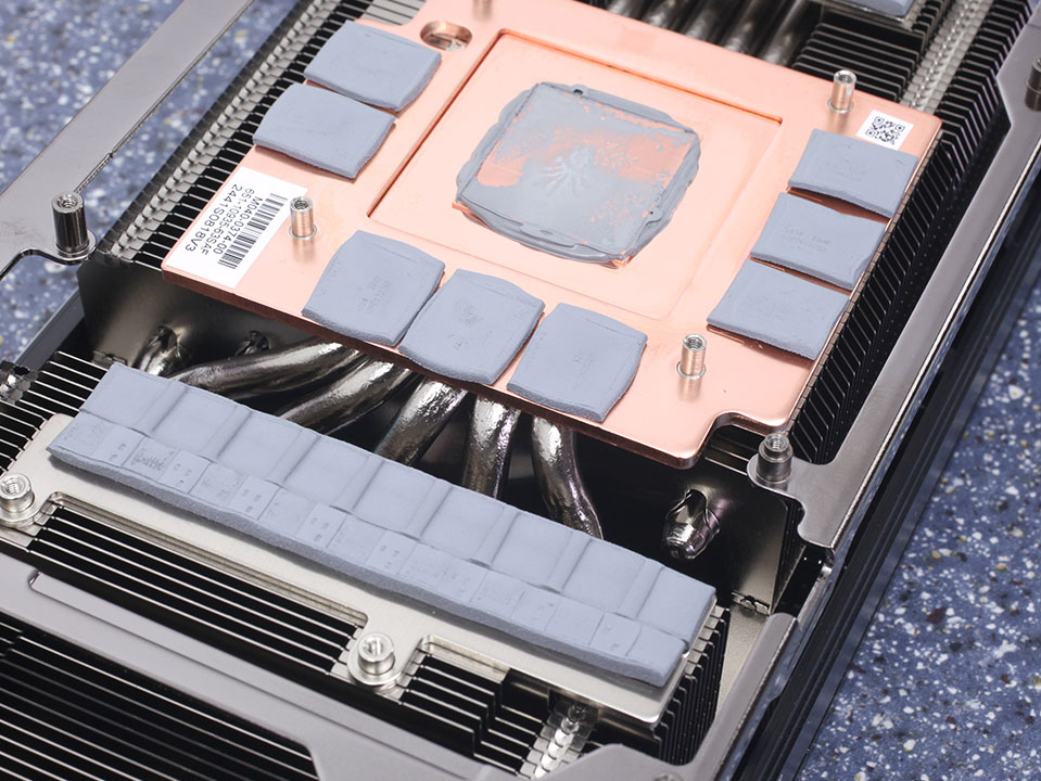

Nearly 10c better than the Nitro+; which, clearly has a slightly 'beefier' cooler.
Physics is telling me there must be something wrong with the methodology (ambient temps? GPU orientation?),
or
Powercolor is the only AIB using superior TIM and/or mounting pressure.
It almost looks like Powercolor opted for much thinner thermal pads and the TIM-remnants look a different color (diff TIM).
So, maybe Powercolor actually did make a superior assembly?
NGL, I'm a little bit miffed at the fact my 'premo' Nitro+ is being beaten (thermally) by some Wet Nose*.

Impressive. Too impressive...
or
It stuck out to me too, but actually PowerColor's 7900 GRE Hellhound is performing similarly to the 7800 XT Hellhound, which was only modestly better than the competition. The Sapphire 7900 GRE Nitro cooler should be close too, but is substantially worse now than when it was used on the 7800 XT (the fan speed graph shows why).
