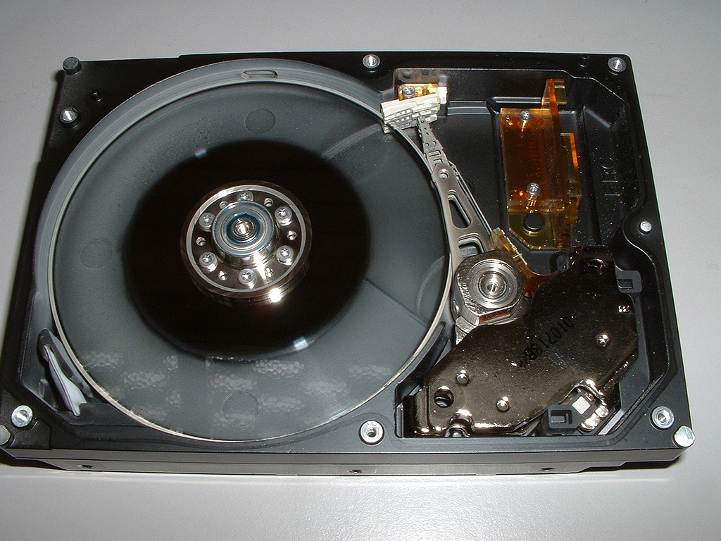

The last hdd that i had a problem with was ibm deskstar: they got labled as deathstar because of how horrible they would fail with the click of doom. Hitachi bought the line and it was a complete 180. Anyways i notice you have multiple threads relating to basically the same problem and I believe you are overthinking on it. Stop it
AHH yes, the (in)famous glass platter drives...
Hard for the drive to read data tracks when they are literally gone...
Yup all over the place in the drive, like brake dust in a drum or crummy pads on disk brakes. Hitachi was awesome, too bad wd scooped them up...
Intriguing, I would have expected the outer coating to hold up better as the heads fly higher there. Or maybe the heads were bouncing when de-parking.
