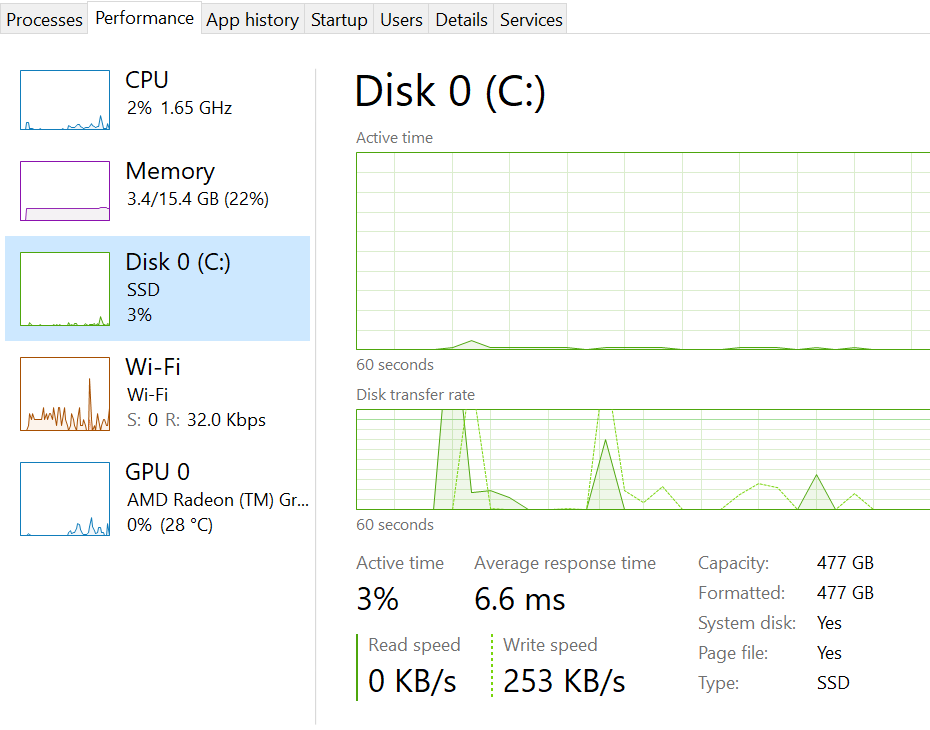

Hello does this happen in all games? Because it could be just be a situation where 16gb is just not enough and the game is using the paging file to read/write data thus the spikes due to it accessing slower memory.

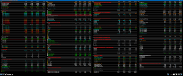

Your SoC voltage is fine
Core voltage (SVI2 TFN) seems a bit low but for 4.4-4.5GHz I think its fine and unless you somehow did a huge undervolt its a non issue. The CPU is self regulating on voltage.
Your CPU temps are on the high side but its normal due to high power limit and average/low cooling capacity.
Have you alter anything in PBO besides just enabling it?
For PPT/TDC/EDC limit settings I would recommend to do them manually.
Limits are unnecessary high now. Not saying that this is the culprit of your issue though.
I would set them to
PPT: 90W
TDC: 65A
EDC: 90A
...for the R5 5600
Defaults are even lower.
The issue of sudden FPS drop spike can be anything. Like a background task briefly taking over system resources or the gaming data that needs to be moved around is too much.
What other apps are you using during your gaming sessions?

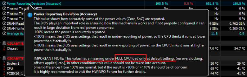

Power reporting deviation(accuracy) 258% ?

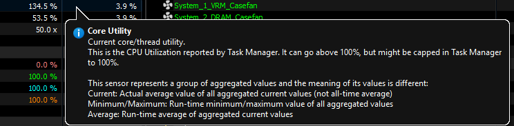

Total cpu utility 122% max 107% average?
No hardware page faults?
Power Reporting Deviation (PRD) can be anything between 0% and 1000% during simple every day usage including gaming.
And it means absolutely nothing on those cases.
This PRD sensor is to be monitored(observed) only on 100% CPU load (Core Usage and Max CPU/Thread Usage at 100% constantly) like on a stressed test or MultiThreaded benchmark or some real MT app like editing or rendering
CPU Utility is normal going over 100%
Please read the description and important note of the PRD sensor tool tip
I would set them to
PPT: 90W
TDC: 65A
EDC: 90A
...for the R5 5600
yes all games. but for me most games use 10gb or less. is there a way to check if a game is using the paging file?

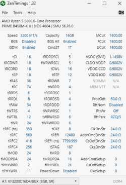

i set the limits you suggested and i instantly hit PPT limit and clocks wont go above 4.1ghz. temps 72
So i set everything in the ram section to auto and turned DOCP 3200mhz. Tested again and its hitting 94% of max PTT while maintaining 4.5ghz. I guess the ram Overclock i tried didnt work for me.
here are the memory timings and voltages. But i think they are very low no?
Should i raise the voltages or leave them on Auto?
I just use task manager to look how much of the disk is being used. Or you can look at the disk usage of a particular program in the processes tab
^ " Small differences from 100% are normal, but if the result is greater than 110% it should be of concern. It is highly recommended to visit the HWinfo forum for further detail"

^ " Small differences from 100% are normal, but if the result is greater than 110% it should be of concern. It is highly recommended to visit the HWinfo forum for further detail”
But only when the CPU is on 100% load. Otherwise you can not take it under account.
As I said on normal usage and on gaming it can be 0-1000% and it means nothing.

It literally says in the description it means over-reporting of bios power, so the cpu thinks it's running at higher power than it really is. How can a curve optimizer function with faulty data?
If you feel this has no impact that's your opinion, not fact. Especially since his cpu was hitting higher temps than it should with 1.2v. Trying to determine his systems issue.
HWiNFO has a sensor about paging file usage. In the memory section of the sensors. It’s the first section before the CPU frequency.
You can check it after gaming
You clearly did not understand that this sensor has a value only under 100% CPU load. Read the description again. On gaming or normal usage is useless. That is a fact. I’ve talked with the author of HWiNFO…
