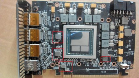

thx i fix that tomorow. another qeustion. these red squared parts do they need thermalpads on it??
My coldplate is different to yours so the short answer is no. It does however have thermal pad on the black MOSFET on the right just below the DirectFet.
**EDIT**: If you leave the card till the next day you may want to try the card again without taking it apart. The thermal pads may have settle down a little by then. You also have too much LM. A user suggested moving it to the middle of the GPU/coldplate. No this will not work. The LM has to go somewhere. So when the coldplate is added back it will come out of the side. Be super extra careful if you take the card apart again.

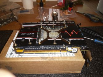

grey 1mm pad are from gilet
green ones are from kritical
so i did what you told me to do... i also found out that the screws i orginaly used are not threaded all the way (first 3 mm) so i could't screw them more in so the pcb didt touch the standoffs on some places so i did this for a fix to see if it works...
and after all that. nothing changed.. stil hot spot 105c and shuts off
i also used a flash light to look between the cold plate and the pcb the pads are toughing the 2 sufraces. and the GPU die also seems to be toughing the cold plate
also kinda starting to think to put back the air cooler on it...
Have you check/look at the documentation of your cooler? 3mm thickness pads, seems like it's too thick. This does mean it's not usable, it's all down to how compressible the pads are, mounting force requirement & what type of pads we are dealing with.
Aren't kritical pads recommend for GPU with original standard cooler. Your using a custom water cooler or am I missing something?.
Aren't kritical pads recommend for GPU with original standard cooler. Your adding a custom water cooler or am I missing something?.
no there was a issue with the thermalpads that came with the block... and the manual is badly translated chinese to english....
i also did allot of googling before hand and afterwards... tough there old articals missing pictures
some say put thick layer of thermal paste on it.. like mx-5 some say liquid metal is the best way to go to beat the hotspot
so far mx-5 did the best for me but still in the end it thermal trotels...
would be fun if it all just worked...

May 12, 2017
2,207 (0.77/day)
Right ok.
But you are using thermal pads from kritical. This website claim 20W m/k thermal pads. I've no doubt the thermal pads work, but suspension lay with they claimed 20W m/k. I'm also not so sure if those pads will work very well with Vega FETS. Remember VEGA FETS are different to most GFX cards out there & those pads are cut to fit specific cards with original heatsink & different type of MOSFET.
This is not to say the pads will not work with your card, it may still perform very well.

what realy troubles me that there is no offical mention from amd or sapphire where the hotspot is mesured. is it the mosfets? is it the hbm? the gpu die??? where??? drives me crazy
May 12, 2017
2,207 (0.77/day)
ive just remember something dont know if its any use but i remember a guy some years ago having a problem with his hotspot being 110c in games and he fixed it with a copper plate inbetween die and cooler i think the size was (30 x 30 x 1 mm) as i say i dont know if its any use but i thought id mention it.
I see, but the extra layer copper shimm is another barrier to the coldplate. It's better to fix the issue where the die has direct contact with the coldplate other than go though an extra layer with thermal paste on both sides of the shimm.
If you solder the shimm to the coldplate then this will cut the losses in heat transfer like what i'm using right now, IHS soldered direct to heatsink.
Nobody knows where it is other than AMD..
Lets get back on track. What are you doing right now to the card?

for my next one im planing to buy waterblock from wel know brand like alphacool.. not touching those chinese brands any more..
im also wondering if im beter of getting a prefit waterblock with gpu from sapphire instead and if i can use my existing tubes on it
if there not press fit on the block...
Feb 20, 2020
9,340 (5.06/day)
Louisiana
Keyboard G710+x3
Hi,
I only said it's the only way to lower the contact area, I didn't recommend doing it.
But after that the op said what size pads he was using which 3mm is way bigger than any nvidia card I seen use that close to the die
I've only installed water blocks on gpu's and nvidia at that
Memory chips are the closest to the die on nvidia cards and I believe they only use 1mm pads
Mosfets/ vrm's are the thickest and I believe 1.5mm and these are the farthest away from the die.
So I'd verify which excact size pads are supposed to be used and use them then see what happens.
