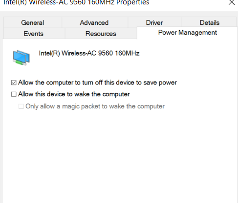

Wifi power settings are normally either in the control software for it OR you can find it in the windows power plan settings (i.e. within balanced / high performance / etc. - whichever you have active) if you go in to the plan settings there may be an option for it, or lastly the device manager additional properties will have the generic power option (doesn't always make a difference). Assuming you're using an SSD in the laptop, you can disabled the hard drive power-down time / set it to a really high number just in case that is somehow the issue (although really unlikely if its the only drive in the system).

If there's no specific option for it then (as most WIFI cards are a PCI device normally) the PCIe power savings option will dictate how aggressive power saving may be for it.
The device manager 'Allow the computer to turn off this device to save power' option may help, but generally that's usually not applied to an active device - within the device properties (where it will list things such as radio bands/frequencies, offloading, etc., there may be a power saving option.
e.g.
To be honest I don't think the Wifi is likely to be the culprit - Source games usually have a constant stream of data when in an online/LAN game (how do you think the ping time constantly being updated is measured) - it's unlikely it would have a chance to go to a reduced power state or sleep if already in a session as it will be constantly sending and receiving within a <100ms window.
