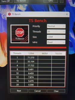

Final settings maybe? Just testing for stability now.

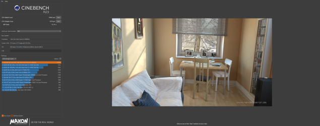

Mouse Logitech Pro X Superlight
Keyboard CMStorm QuickFire Mechanical
VR HMD Oculus Quest 2 (Virtual Desktop)
@carlos1172 My single core performance is normal here...
US version of your laptop. I did the above tweaks I mentioned plus -125 mV undervolt on CPU P cores and P cache, and what unclewebb mentioned with IccMax maxed out. BIOS version is kwcn35ww.
My multi-core score is on the low side because it's from a 10 minute run, not a quick single run.
Feb 19, 2018
29 (0.01/day)
Try checking the Speed Shift box in the TPL window. Set Speed Shift Max to the max so it does not interfere with the maximum multiplier.
If that does not solve the max multiplier issue then I am not sure. There might be some conflict between ThrottleStop and the Lenovo software you are running. I will probably not be able to solve this mystery until I buy some new 13th Gen hardware.
Edit - Perhaps your AVX Offset setting is part of the problem. Set that to 0 when testing.
That is a nice free performance boost. Less throttling is always a good thing.
Speed Shift Max should be 0 or 255?
Is this okay?
