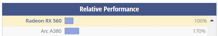

I tried 4K gaming with an ancient Radeon RX 560, and this thing here is much faster.
LOL this just gets better. Again from this very review, CS2 at 4K is 15 FPS. Are you doing OK or just having a fun troll?
