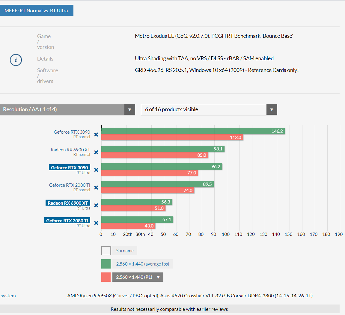

So have people tried any Ray Tracing benchmarks on 6900Xt/6800XT cards? It seems that both these cards are placed between 3070 and 3080 for RT performance (reasonable settings).
Native RT performance for the 6800XT is between the 3070 and 3080 indeed, with the 6900XT being closer to the 3080 and 6800XT closer to the 3070 in terms of 3D Mark scores.
The RTX 3070 averages around 8300 in Port Royale, whereas the 6800XT is around 9500, 6900XT is 10300 and RTX 3080 is 11500. I can personally hit around 10600 in PR with my 6800XT under water and pushing 2.7Ghz, so if you manage to luck out and get yourself a good chip, you can push it a bit more.
In games however, there isn't much to separate the 6800XT and 3070. Watchdogs Legion delivers better performance via the 6800XT by a couple of frames when RT is turned on for example.

Not so much benchmarks, but in RT games they are between the 3070 and 3080 in regards to RT performance generally speaking.
I was going by performance in Metro EE, synthetics and some AMD sponsored titles. Though if one is limited completely by RT, it seems that 6900XT barely exceeds 3070, at least in Metro EE. The thing is, game scenes are not just completely rendered RT effects and thas why RX 6900 XT can almost match rtx 3080 in Metro EE benchmark with all RT effects on but it falls behind in RT limited scenarios. So the problem is we don't know what amount of RT is good enough and what is pasted in RTX games (almost all sponsored by Nvidia) like 64x Hairworks or Teseelation times 30.
Yeah. That seems about right. I can get ~11100 Plus on my RX 6900 XT. The thing is, is this the correct performance for reasonable RT? For e.g. For RT Normal has good performance below but RT Ultra just tanks 6900 XT. Also, watch that they have turned down the raster setting one notch to make scenarios RT limited since increasing the raster setting helps alleviate stress on AMD in this particular title.
Interesting graph, thanks. It would seem that even the 2080ti/3070 stands up well to the 6900XT when RT is extensively utilised. The less RT becomes a factor, the further away the 6900XT pulls as you say.
But that's the point. Is RT being heavily utilized? The problem is that we don't have a proper RT showcase game from AMD to give us an alternative to Nvidia-sponsored RTX games. Also, you might want to read the relevant bits of the article as it seems that Hairworks might be causing huge performance dips on AMD. The best sort of "objective" test that we have is 3D Mark Port Royal where RX 6900 is ~10% behind an RTX 3080.

I'm currently getting around 53-55 degrees (hotspot of between 70 and 75) under water with Kryonaut on my 6800XT drawing around 370w overclocked to 2.7Ghz (2112Mhz Fast Timing Memory).
What sort of temp drops would I likely get by switching to LM with the above settings? 5 degrees? 10 degrees?
my 6800XT with LM was -12c on hotspot and -10 and core vs Kryonaut
Feb 14, 2021
29 (0.02/day)
Probably 10c but liquid metal can destroy aluminium potentially damage gpu if not used correctly, its probably also conducting electricity so you dont want it touching parts it should't altho i am not sure about that last one.
Really? Interesting. I've heard people use nail polish around the GPU die to ensure the LM doesn't short any components it may touch should it leak/run. I've also got myself an EK Quantum Vector block which is Nickel-plated Copper so that shouldn't pose a problem.
That's amazing. So I could be looking at anything around 45 degrees with LM and a hotspot of 60-65 at full load. I think I've pushed my card as far as it can go when overclocking. I doubt it'll be able to push it higher than 2.7Ghz stable in games but the temp drop is worth considering.
Nickel-plated Copper would not have issues with LM, only copper and aluminum have issues with LM, aluminum has most problem with LM, copper a bit less, and nickel plated basically none, except maybe some staining but not corrosion. In the past I also used LM on a copper heatsink, id did some very minor damage, but nothing to bad. On nickel LM is almost harmless in general.
I was amazed by how much the temps dropped after applying LM on the chip, was expecting a good drop but not as much :) I used normal MX4 thermal paste to cover everything around the chip so that if any LM drop would travel somewhere else, it would not cause any damage, since its non conductive and easy to apply and cover, and also easy to remove, plus being a heat conductor :D
For the 6800XT, 2.7ish is the max it can go, I read somewhere there was a good rason for AMD to put 2.8 max, since the logic inside the chip could not handle more than 2.8. The only reason for applying LM is to have great temps, and maybe to help stabilize your max overclock. For me it was 100% worth it, just for the temps, I am also getting 2.7, 2725mhz at best.
Temps are around 44-45c on chip and 56-57 max on hotspot with a 350w max limit, usually using 310-320w.
