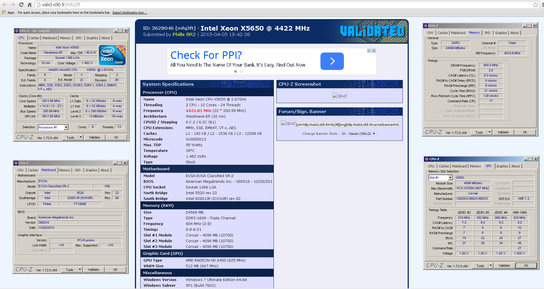

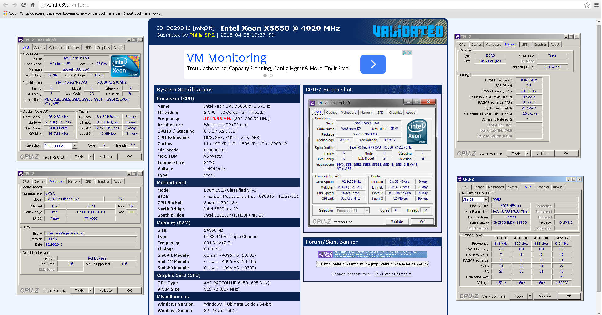

When I was overclocking my X5650's, I had a higher BCLK than multi... I believe it was something like 200 on the 'FSB' BCLK and then whatever multi... I'll dig out the Screen shot....
I never really played about with it so much but I don't think I had the best of Xeon's for overclocking, but then I don't think the 48GB of RAM I had in the system helped either... Which is why I swapped it out for 24GB which was again still too high really.. At the time I didn't have 2GB sticks and only 4GB ones which came with the SR-2...
If I ever get around to it again, I'll see if I can get the beast fired up and see if I can figure out a few overclocks :) It does have in it a pair of X5675's now... I think it's about time we saw if the thing worked still!! lol
