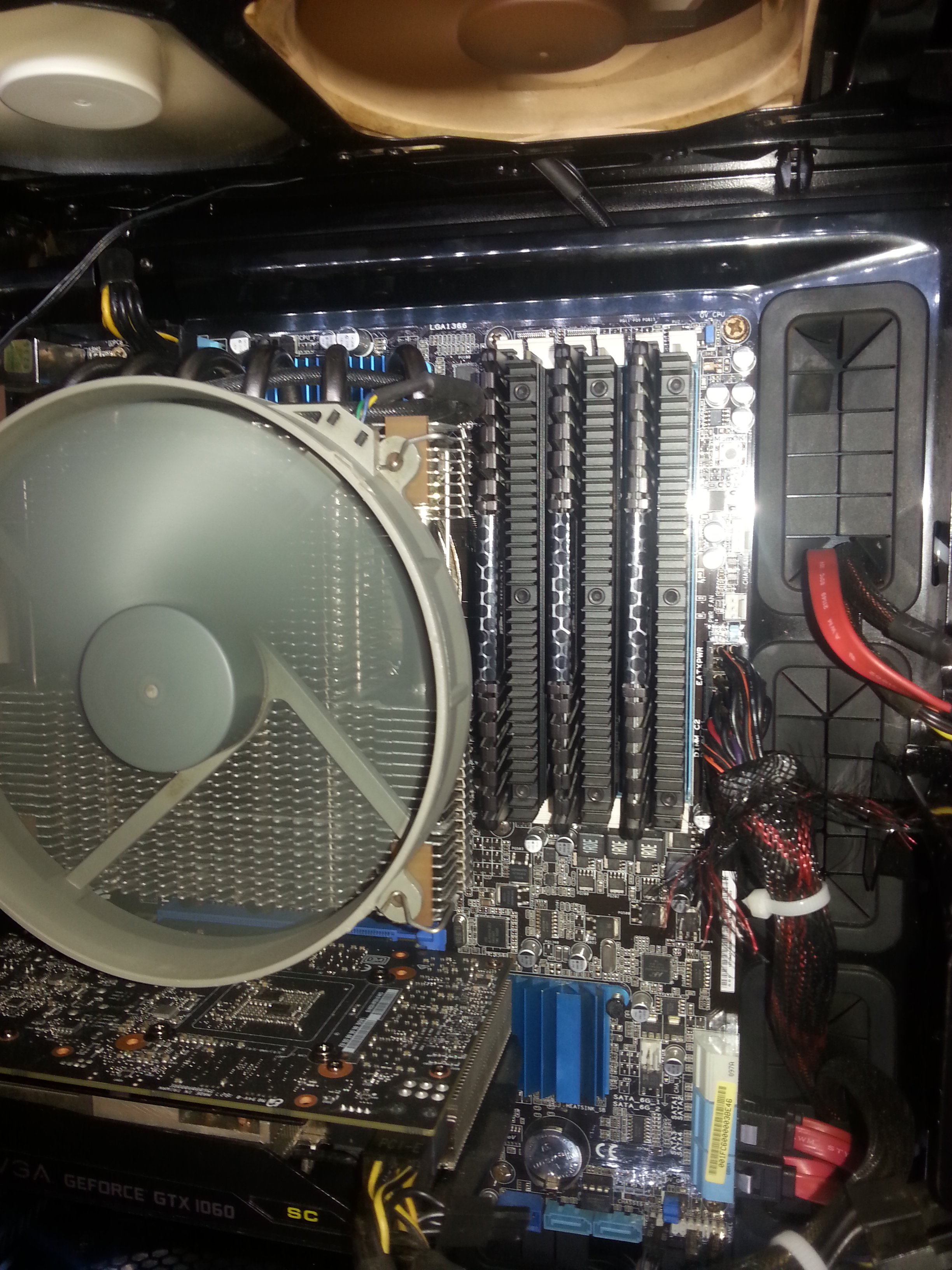

it back up and running only got the board this morning as well rotated the heatsink to make it clear the tall rams sticks
Had to use the rams that came with the board since my old set of corsairs one or two of the dimms don't get along when fully populated as I think it possible failing

View attachment 252633it back up and running only got the board this morning as well rotated the heatsink to make it clear the tall rams sticksView attachment 252634Had to use the rams that came with the board since my old set of corsairs one or two of the dimms don't get along when fully populated as I think it possible failing
