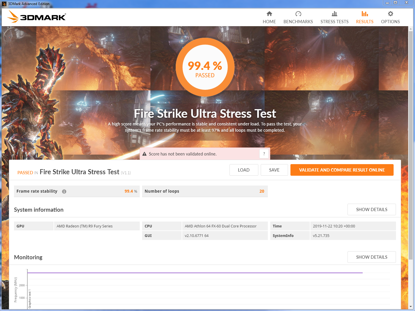

After modding my Nano I made an error, but did not see it. To my surprised when I opened up HWMonitor, it showed Power, but no TDP readings.
I removed the fault at the controller "short circuit" & now HWMonitor does not show power symbol.
Question is why is power reading missing from GPU-Z & HWMonitor for Fiji chips.
New personal best not just in speed "1070MHz", but a new record low for temperature on air. It's going to get an even higher benchmark that's for sure.
Screenshot of benchmark with latest internal modifications.
