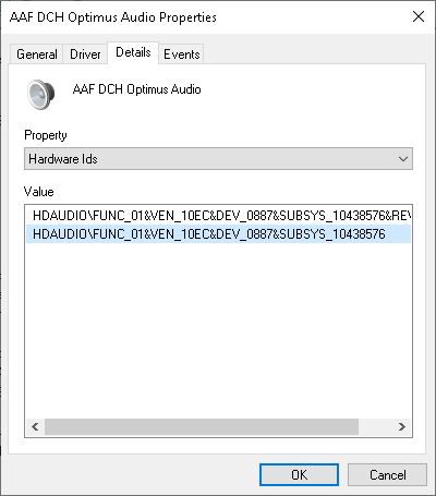

Okay. So the sound device driver looks good. But I still can't get DTS Interactive to show up.
I think my problem is that my motherboard shows the device as Realtek USB, even though it's SPDIF. Any driver I installs doesn't change this. I've tried AAF optimus DCH build for DTS interactive on Realtek USB devices and still nothing shows up. I have an MSI Z690 EDGE WIFI DDR5 mobo, and from what I can tell they may not have paid for liscence for Dobly and its somehow blocking me?
Maybe use Driver store explorer and (list from Alan Finotty) remove all the following categories of drivers: "Realtek", "Dolby", "DTS", "Creative", "A-Volute", "AAF Optimus", etc in the "Sound, Video and Game Controllers", "Extensions", "Software Components" and "Audio Processing Objects" device categories. Excluding Realtek network if you have it.
Then restart the entire process again, motherboard licensing should not matter because if the manufacturer had licensed their board we could stick to using the manufacturer's drivers. I've never seen an onboard Realtek digital output show up as a USB device though. Mine shows up as ATAPI but I had to use a header plate due to the fact the board only has s/pdif pins on the board.
Edit: Just checked the specs of your board and it is indeed connected via USB. Info about your audio chip the ALC4080
