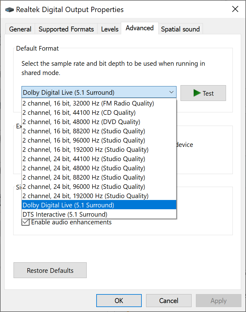

Hey guys just checking after a while whats the latest working method to gets DTS Interactive / Dolby Digital Live working?
Planning on upgrading to Windows 11 so worried my old method is no longer gonna work
I'm currently using dvojinov method and 6.0.1.8059 drivers (only thing what worked ) I need this because of my Logitech Z906 speakers only way I can get 5.1 DTS over optical for games

Strange case for me...everything installed correctly (with Asus last patched drivers).
When I test sound in "supported format" (2nd tab) I can hear the sound in the 5.1 speakers:
but when I test the sound in "Advanced Options" (4th tab) I can only hear 2 frontal speakers working:
I did some tests with dts/dolby 5.1 video demos and it works like a charm but when trying to play games only 2 speakers (Doom Eternal, Cyberpunk 2077 and A Plague Tale...)
Someone has this problem also?

Hi,
I followed the steps here on my Windows 11 PC, but I am still not seeing the options for Realtek HD Audio Manager. In fact, it doesn't seem to be installed at all.
I'm running an SPDIF cable from my motherboard's IO to my Onkyo receiver.
  1. I uninstalled my existing Realtek drivers with Display Driver Uninstaller (DDU) and booted into Driver Disable Enforcement mode.
  2. Downloaded and extracted the zip file containing the Realtek HD audio drivers R2.80, then used Pihto's patch to patch the DLL files in WIN32 and WIN64.
  3. Ran the Realtek setup program.
  4. Opened regedit and created the "DisableProtectedAudioDG" registry item.
  5. Rebooted.
But I seem to be back where I started.
  • "DisableProtectedAudioDG" has disappeared from registry.
  • Realtek HD Audio Manager isn't installed.
  • I have no options to enable Dolby Live or DTS Connect.
    I can test Dolby and DTS under the speaker properties, but it doesn't enable during games.
I am not sure what I am doing wrong. Can you please help me?

I'm on a Gigabyte Z390 and can confirm the process still works.
The trick for later drivers is to download the v2.8 drivers and patch as normal then rename the patched dll to match the version in the desired driver. eg rltkAPO64.dll may become rltkAPOU64.dll. Then copy to the desired driver install folder and follow the install process. Here's my notes I made for this process.
1) Download Realtek v.2.80 drivers https://www.techspot.com/drivers/driver/file/information/18007/
2) Download the updated driver you actually want
3) Use the Patcher to patch the files in the v2.80 folder
1) Copy specific patched dlls from v2.80 folder and rename to match existing files in the updated driver install folder, eg RltkAPOU64.dll - remember to backup the original files
2) Run Display Driver Uninstaller to remove Realtek drivers
3) Reboot to UEFI to disable driver signing requirement. Or just reboot if already disabled
4) Remove auto installed Realtek driver via driver manager
5) Install new patched driver
6)Add reg key for DisableProtectedAudioDG
7) reboot
For the reg key copy and save the following to a text file and rename to DisableProtectedAudioDG.reg
Code:
Windows Registry Editor Version 5.00
[HKEY_LOCAL_MACHINE\SOFTWARE\Microsoft\Windows\CurrentVersion\Audio]
"DisableProtectedAudioDG"=dword:00000001

Does DTS work with digital output only? I have B550 AORUS ELITE V2 (ALC1200), win10 and 6.0.9496.1 driver from gigabyte. Driver is patched but changing to dts for speakers is not working.
I will explain why I need DTS. I have 5.1 speakers connected with three jacks. When I was using Gigabyte X48-DQ6 with chipset ALC889A I cannot obtain 5.1 sound on 2.0 stream. Therefore I turned on DTS to have always 5.1 even on 2.0 streams. I was using original driver 2.70 from gigabyte (DTS was supported in default, no need to patch).
Now, on new motherboard I have the same. 2.0 streams are not played as 5.1. Is there any way to fix it?

hi OP i just fresh installed windows with 23h2, ran DDU and did the registry, the panel its not working but still, i can set the dts option on control panel -> sound is there any way to get the panel working ? for mic functions (echo cancelation and so on)
Greg636
Nov 26, 2023
2 (0.01/day)
God knows how i was able to do it. It works though :)
First i installed some apo and fx settings or how they are called that i saw on reddit and youtube. Didn't work. Uninstalled this stuff. I already made a system restore point before that. I didn't restored, just uninstalled this stuff that didn't work. Then i tried the method here with the mb manufatured driver.
I downloaded 2.80 and patched the 2 files required. Then renamed the RltkAPO64.DLL to RltkAPOU64.DLL which is the only similar file on my msi's audio driver. Overwrited the msi's file. A couple of tries, ddu and audio stuff uninstalled it worked! It said one time unassined driver. Although i have left in device manager a duplicate nahimic mirroring device that doesn't work. It says device is busy. I disabled it. Everything looks fine.
Then i tried to system restore thinking this duplicate was from apo and reddit stuff that i tried since then it was when i spoted this. Restored system, device manager looks ok, trying again to do the driver patch thing. No matter how many tries it won't work. It didn't notified me for unassined driver. Device manager is ok though. Undid system restore point (got duplicate nahimic again) and after of couple of tries it and again 1 warnging about unassined driver, it worked again.
No idea what is happening. I am leaving it as is. I would really like a cleaner solution though.
Edit: I tried @bottlefedc83 solution and it worked like a charm. I restored windows so i don't have the duplicate nahimic in device manager and it worked flawlessly.
You guys are making this too hard, you don't need to disable driver enforcement or anything, just patch the .dll then rename it to RltkAPOU64.dll boot into safe mode, if for some reason the audio driver still launches just disable the service, then copy RltkAPOU64.dll overwriting the installed one in "C:\Windows\System32\DriverStore\FileRepository\realtekapo.inf_amd64_86fc0b0b9eccc8ac" or something similar, you will see it. Reboot and enjoy. I have even done this without booting into safe mode by disabling audo endpoint builder and audio services. As long as the driver isn't trying to load the .dll you can overwrite it and reboot.
The patched .dll are a pain in my opinion not because of the method described above its because how realtek handles the implementation. If you patch the .dll you are leaving realtek SFX/MFX/EFX to handle the DTSi & DDL since realtek loves to kill off using the system mixer unless you manipulate SFX it will only output stereo despite the endpoint switching output channels to 5.1, a problem many run into still. This is fixed pretty easy by inserting Microsoft SFX ,{62dc1a93-ae24-464c-a43e-452f824c4250}, into your chain so the system mixer can see what EFX output channels are and act accordingly. For example when I used to run patched .dll to get DTSi I would need to configure my FX configurator as follows:
