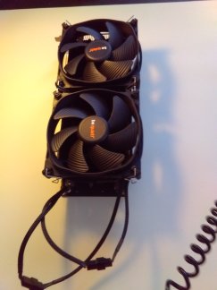

A couple years ago, I modded the reference cooler on a Vega64. I bought this huge Raijintek Morpheus 2 cooler and ran into a similar problem of the uneven HBM/GPU die. I couldn't keep the GPU/HBM cool at even temps. At times it was 15c higher than the GPU. I was getting tired of this Vega card till read where someone had used the original mud that came with the cooler. This guy said to paste it 'moderately heavy'. Yahoo. This did the trick. Apparently Raijintek knew the problems associated with the Vega series but failed to disclose this anomaly. The GPU/HBM off-space was so fine a difference in height, it was hard to find a milled copper shim that thin (I was getting my copper from an auto parts dealer who told me to go find a jeweler who deals with hobby metals). In 2019, Raijintek stopped offering the Morpheus 2 cooler for the Vega series. Shame.
But anyway, the other heat problem I encountered was the chokes would heat up past 90c. I applied aluminum fins but got less than a 10c difference and would fall off with attaching thermo pads. Then I used copper fins with thermo glue and that made a 20c difference. 75/80c was acceptable. I was absolutely enamored by my undertaking. I felt like James Brown! And I got carried away. While venturing to file the top of the heatsinks under the mounting bracket arms, I busted the choke top clean-off. Bummer.
I was able to re-glue the choke together but to make a long story short, I could only run it at stock settings. And it was never cool again.
I politely coerce a friend to sell me a lack luster Gigabyte 2080 S which soon replaced it by an EVGA 3080ti.
I've been too disappointed to do anything more. To be honest, I I think the Vega's resolution was far better at rendering in that it was beautifully smooth, concise and detail at higher clocks. Tuning up the EVGA 3080 ti, (not to be kidding it's fast) had a slight mushy quality. I had some minute screen tear. Couldn't adjust it on a Freesync monitor

@Muck Muster Ye looks like a Ship lol but the thing is this still heating up xd, this card still needs some upgrades, the big improve is that i remove the blower fan, oh god that thing.
Heat. That's the problem I had. All the vram, MOSFETs, voltage regulator modules (vrm) and chokes need to be cooled. At first, I bought a bunch of small aluminum heatsinks and tack them on with double face thermo tape. They fell off. So I used thermo glue.
The thermo glue worked O.K. but the aluminum heatsinks didn't do the job. So I bought copper fin heatsinks. I had to shave off the tops of the copper heatsinks on the chokes closest to the gpu (the gpu's cooler bracket was in the way). I use a heat gun and acetone to eat off the thermo glue. But I busted off the top of one of the chokes. Bummer. I was able to glue the top back on but it didn't work as well. I'd have to un-solder and weld in a new choke. That would be time consuming. Ugh.
All of the aluminum heatsinks I replaced with copper heatsinks did well under the infa-red thermo gun except for the one I re-glued choke (which was almost 20c higher than the rest). At best, I was able to run 'zero' base clock speeds and mem. Not so good.
So I called a friend who sold me his old Gigabyte Nvidia RTX 2080 S (Wow. Wasn't a good graphics card at all.) The Vega64 had much better visual (eye to screen) quality resolving details, speed, texel and pixel rate. I was blown away by that. Everyone who says 2080 was better card than Vega hasn't played with both.
I think it has something to do with Vega's monstrous 2048 bit bus width. It packs a lot in the picture. The Nvidia 2080's 256 bit bus width is way too small. That's where I think the Vega series really shines.
So I fished around for 6 months for the best graphics card deal available. At the time I was hoping for an AMD RX 7900 XT which retailed $1000, had a 380 bit bus. But I just happen to find an EVGA 3080ti 384 bit bus for $600 and couldn't pass on it. Gave the 2080 S to friend who put it in his VU BF3 server. Truth be told, servers don't need a 2080 to run.
These are the heatsinks I bought for the Vega64
Newegg always runs out of these small copper heatsinks so you may have to find an electronic parts E-store or the manufacturer's website. The thermal glue I used was Gennel 10 gram Thermal Conductive Glue (I don't recommend this brand. It's just O.K.).
Long live Vega.

@LabRat 891 What's the CFM rating on your fan? I can't remember where I saw it but IIRC it requires at least 40 CFM through the heatsink.
I used a pair of sanyo 60mm 5600RPM fans totaling 52 CFM on mine prior to watercooling it and worked alright but even with those fans the amount of air getting through the heatsink was not exceptional.
Based off the Amp rating compared to other 120x38mm fans I am familiar with, it should be north of 150CFM. I don't have the spec @ hand, but based off experience, it is DEFINITELY well over a 100CFM fan (in open air).
(I chose a 120x38mm fan, as they develop more static pressure, and used the non-porous Al tape to create a pressurized airguide)
Again, only speaking from experience, it feels like more than 40cfm coming out the exhaust of the card. (As compared to 35-55cfm 80-92mm fans I've played with)
