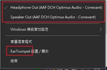

Maybe you install too many kits, and I only install one that suits me.
Don't tick too many suites at once. The problem can be clarified.
My laptop's built-in sound card [Conexant]
Microsoft drivers will be installed every time you are connected to the Internet.
So in order not to cause some strange problems.
I installed AAF by disconnecting the network.
I also installed EarTrumpet to quickly switch headphones/speakers

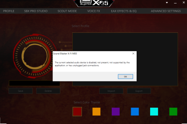

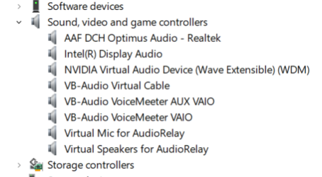

Anyone know how to fix this? I had realtek audio but I removed it with DDU and installed AAF.
I checked in driverstore and I don't see anything about realtek, but I also can't seem to find any mention of AAF anywhere.
I do have an nvidia driver in the sound controller category but I haven't used that at all, I don't even know what its supposed to be for.
This is on a Dell inspiron 5577 laptop
Sup So Yeah Your Not Doing Anything Wrong At All,
Alan Said To Do "/Register SKU" During Install Of SB X-FI But We Got No Clue What That Means, So Just Ask Alan.
EDIT: Forgot Main Question XD, Ok So Delete AAF Then Download It Again Then Try To Install Make Sure Your Download The HDAudio One Unless U Got Realtek Audio.

Maybe Wait It Takes Time To Make These Driver (I Think) I Know That First You Need The KGA's For It To Activate, Plus U Also Need To Make The Driver Compatible This Will Take Time If Alan's Interested, So Wait Maybe PM Him If He Isn't Responding For A While.

I reinstalled AAF and it appeared and replaced HDaudio, But I don't hear anything from the speakers or headphones. There is music playing and when I play a recording of my laptop from my phone I can hear the sound, but no audio from the laptop speakers and headphones. What do I do?
First Was There Audio Before?
If There Was Try Using The One Made Specifically For Realtek Audio, Maybe This Driver Isn't Working, Or If It's Still Not Working Try A Different Driver.
roccatagliata
Jan 21, 2023
9 (0.01/day)
I also had issues when activating dolby digital, I get all sound muffled.
Reverting back to previous version fixed it.

That's the one I downloaded, there was no options to specifically choose realtek. It just installs directly and asks about features like dolby, dts
This Thread Is The One Based Of HDAudio, And The One I Sent Is The One Based On Realtek Audio And The Pictures Are Of The HDAudio.
Coolburritoboi
Feb 6, 2023
4 (0.01/day)
Reinstalled with that version and I have the exact same problem, audio is present but nothing is heard from audio outputs
