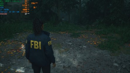

i copied all 3 files from Alan Wake 2 DX2Vulkan.zip into my game dir,i update my driver gpu card to the latest version,and now i have 30-37 fps constantly.....it's much much much much better.Before i had 22 fps,and now i have 37 fps.The game is much smoother now
thank you
thank you
Welcome man , glad it helped a little bit , you should try the second zip too ( Alan Wake 2 DX2Vulkan Async.zip) , you may gain 3 4 fps more if you are lucky(you could try OC-ing your GPU vram , + 4-600mhz on mine gave me like 2 -3 extra fps, maybe is more impactful on your GPU) , also maybe they will release a new patch at some point with some optimizations (and usually outside that forest you should get better fps).

the max fps i can get is 37-38 fps in some zones,but the game is still choppines for this old card,no way.This game require DX 12_2 ultimate capabilities.
But i am glad i can play with 37 fps now instead 22-24 fps....for me is much better
thanks again man....

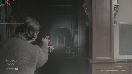

Guys can i copy this 3 files also when i using GTX 1050 ti ? and this 3 or this 3 async ?
i had no problem playing just i see some graphics glitches in forest you go then you see textures over you like in river :D
on alan wake levels no problem now i am in hotel 665 room.
on kavalanga i had problem with lock cos it show on lock only white squares without any symbol so i set shader res to lowest then it showing symbols in white not in red but somehow i unlock it
i normally play on 1902x1068 res and shaders to quality. Dont know how much fps but it playable.
hope someone make patch for this shaders glitches...

Yes , i think that any GPU that supports Vulkan can use it, it will translate the DX12 into Vulkan so there will be some overhead but it might help some older cards to run better, i was getting the same performance as normal with them on 2060 super.
Im curios to see how an 5700xt will do with them, if any gains to have there, or even older cards like RX 580 or Intel Arc.
It seems that OP got an performance boost of 50%+ with them on 1080TI.
They can also be used in other games that are using DX12 and they are not supported by older GPUs but its a hit or miss , not sure which games or GPUs will work with them and which won't , you just have to try and see, also if your GPU is already running the game correctly i think this MOD will only slow it down but costs nothing to try it if u want .I also think that you have to be on Win8 or higher , perf on WIN 10 or 11.

yes works for now works smooth i see if there is still graphics glitches...
