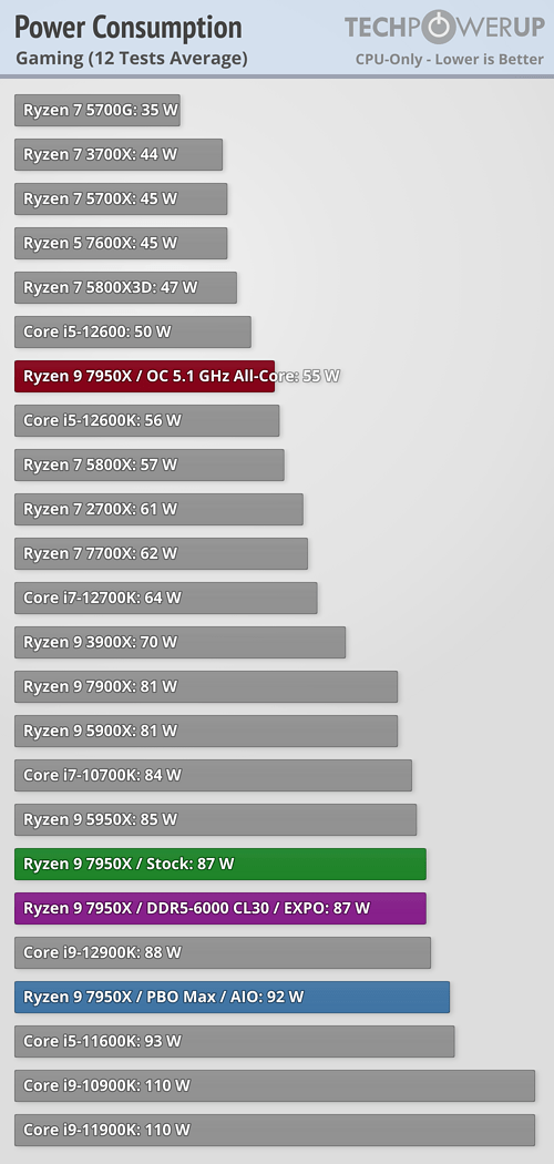

You share? In @W1zzard's review of the AMD Ryzen9 7950X it have a average of 125W and the Ryzen 7 7700X of average of 80W.
So think about it, the Ryzen 7700 non-X averages 57.4W in games so if a well AMD tuned Ryzen 7 non X 3D would do about 65W on average it would be a killer gaming CPU because we saw with the AMD Ryzen 7 5800X3D how much fps gain there was with the extra cache in gaming while not using an insane amount of watt.
This would make a lot of customers happy in countries where power still costs money you have to think outside the united states of america because they do complain about thinks but they get them in bigger sizes than other countries so they are still cheaper than the rest of the world.
I dont know what are you referring to.
In the 7950X review the average of gaming is this
87W.
12900k averages less than 57w in games.
it depends on the game, but my 13900K is around 80W.
which is exactly the same as the 7700X, just with slightly lower boost clocks and voltages.
few bios tweaks and slight oc it is the exact same sku. with the same max fclk
87W.
I saw the Application power consumption.
