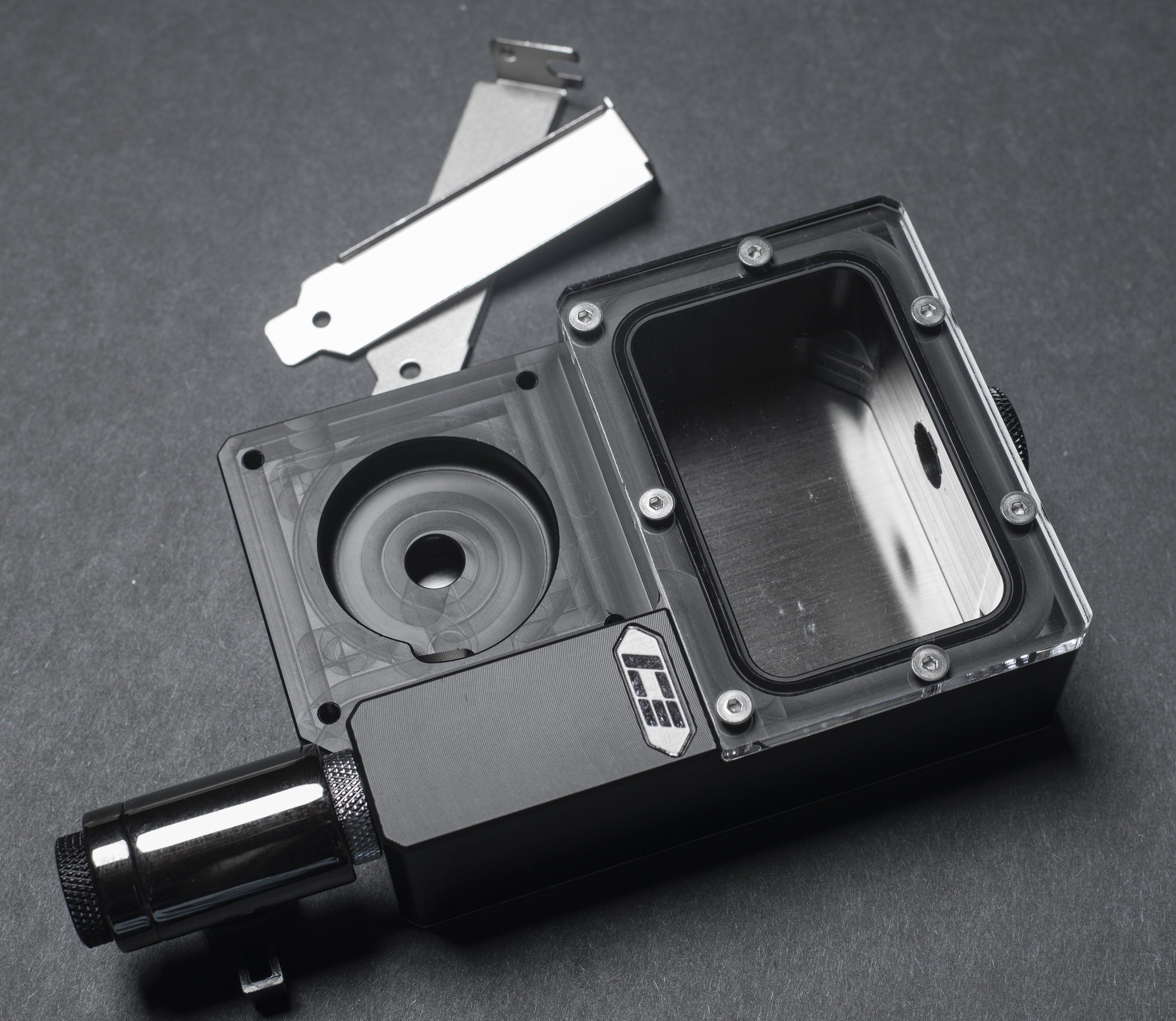

Whoever designed the Iceman res, hats off to you. Materials are good, tolerances are good.
Whoever assembled the Iceman res, you should know that there exist such things as nitrile gloves... :wtf:
I don't like having to disassemble a brand new res, but this is disgusting (on the inside of the res, clearly visible through the acrylic front plate):
The stainless steel backplate was completely covered in oily smudges and fingerprints. The acrylic front plate was also smudged as hell, and unfortunately all of it was on the inside surface. It was clearly just from O-ring lube, but seriously, is it really that hard to assemble this without getting your oily fingerprints all over the inside??
Fortunately, the O-rings, screws and fitment are all good and it was easy to wash off with a gentle soap wash, dry and put back together. Made sure to tighten evenly in star pattern (that automotive and manufacturing experience did come in handy after all). Probably won't be possible to leak test/verify the res alone due to the design. I guess we'll find out in due time if my reassembly was up to spec.
Looking much better now, minor scuffs more visible now, but doesn't bother me nearly as much knowing that the insides are clean:
That's a nice looking unit! Agree on the cleanliness thing though, that's rather extreme. Also, is it actually stainless steel, and not something like nickel-plated copper? Isn't that a bit iffy in terms of galvanic corrosion? Or is stainless steel+copper not an issue? You'll definitely need the pump to leak test it - or I guess you could make a metal plate to cover that opening, plus an o-ring underneath it. Plugging the holes in any other way would be very unlikely to stand up to the pressure from the leak tester.

Also might take the opportunity to clean out my CPU block (some assorted gunk in there), as well as switch to a Mayhems clear coolant. I'm not sure I trust EK anymore, Cryofuel has been depositing this thin almost oily foggy residue on the inside of the res. Nothing gunky, nothing major, but not something that should be there.

I'm seeing that same residue
I've also had some bad runs with EK coolant, who were also my first coolant choice - so i wasnt sure whats normal and whats product faults
Most of the residue comes off easily, but the stuff that accumulates at the water level in the res never really comes off. I had the res apart and scrubbing gently with microfiber and dish soap, everything else comes out sparkly clean but the oil at the water level line is still easily visible after cleaning.
Disappointing since according to the label there should only be distilled water and a tiny bit of 2EHA in Cryofuel.
I have never heard anything bad about Mayhems, so I was looking at their X1 v2 clear. Koolance 702 came up sometimes in forum threads as well.
I've seen that same residue in all my loop variations using Cryofuel, so it seems like a common thing. Doesn't bother me though - especially not since I ditched my large res :P It also only seems to stick to certain plastics (acrylic, possibly the neoprene ZMT tubing, tiny amounts on acetal) and doesn't really build up over time, so I ultimately don't care. After running it for ~two years without any service with both bare copper and nickel-plated blocks in my loop and both being essentially clean afterwards, it really doesn't seem like a concern. I can completely understand it if loop aesthetics matters though.
