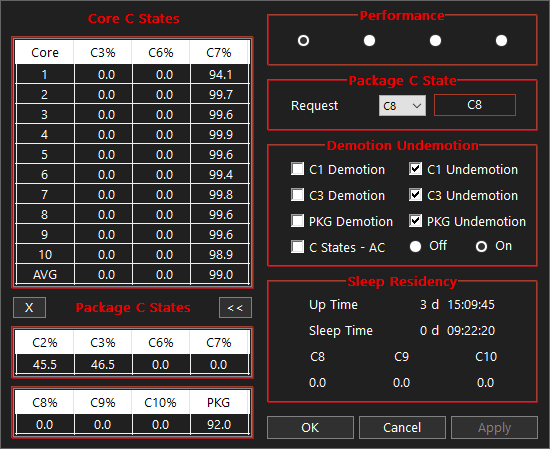

I just restored plans to their defaults but both Balanced and High performance refuse to enter lower states. This is really strange.
All I did was turn off C-States when using High Performance profile.
I'm using Balanced right now and as you can see c3, c6 and c7 are at 0.

Try setting the Package C State to C7. This should not make any difference to the core C states but worth a try.
Did you try pressing the Restore plan defaults button in Power Options?
Did you try selecting C States - AC and the On button and then press Apply?

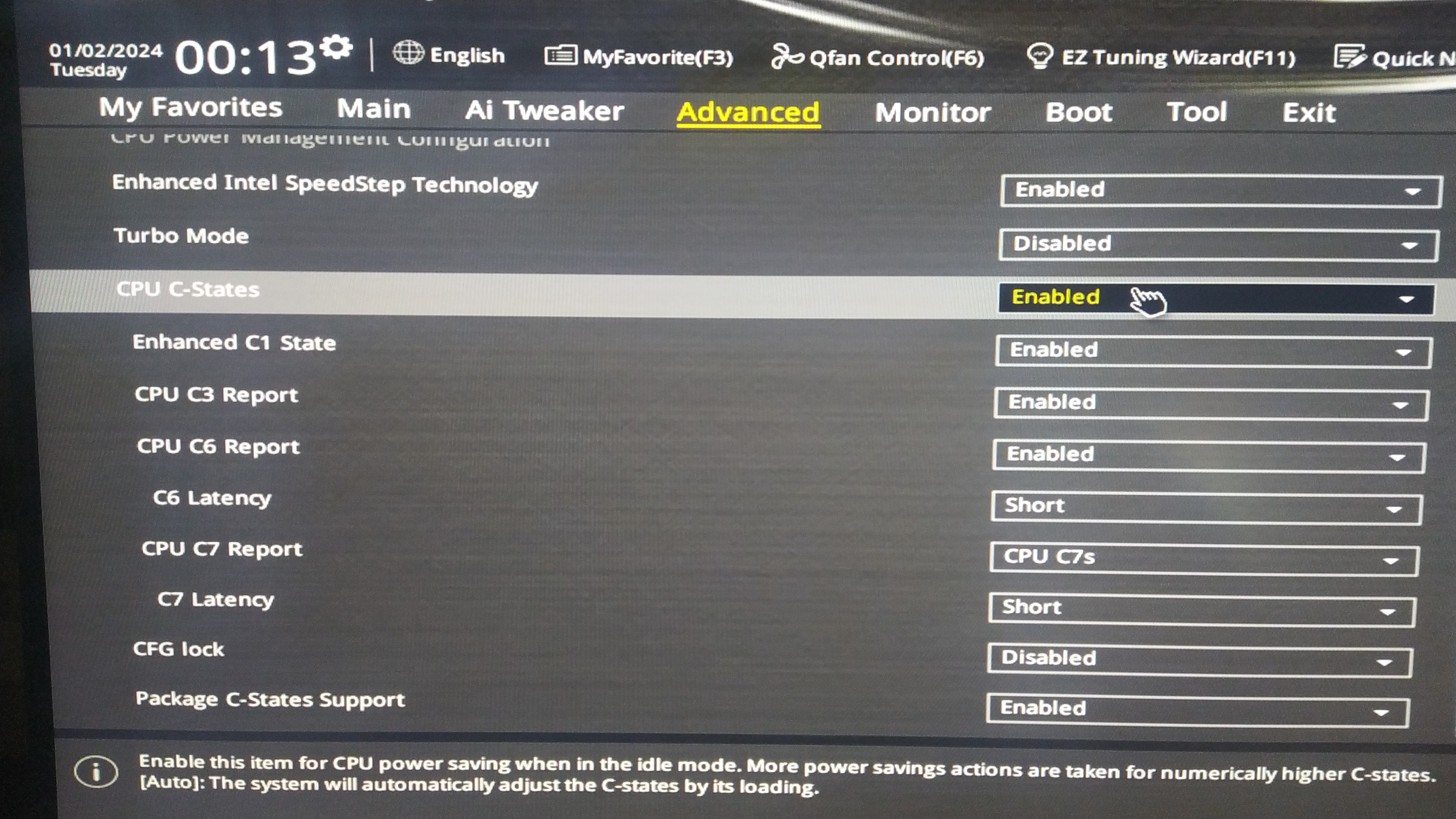

As I mentioned on my first message, cpu was on C7 most of the time, so they were working.
I actually did restart the PC before but no help.
In BIOS C-States are set to Auto.
I have cpu turbo mode disabled but that shouldn't affect C-States.

Instead of using Auto in the BIOS set the C States to enabled.
Try setting turbo to enabled in the BIOS. There is some sort of incompatibility between how your BIOS is setting up the C states and how Windows is setting them. The problem is probably the BIOS.
MatrixQW
Jan 1, 2024
12 (0.04/day)
You are correct, enabled in BIOS they work. Strange thing is they were working with auto when I installed Windows.
In BIOS I have Enhanced C1 but in TS the C1E is not ticked as you can see in these pics. Why is that?
And now in demotion/undemotion, C1/C3 are ticked but not PKG. What are these for?
I'll answer myself the first question: I had to delete ThrottleStop.ini so it can read correctly the values BIOS gave the OS.
Since I have a Z97-K board and a K cpu I can disable C-States and cpu turbo mode keeps running.
This is nice, I keep the performance without added latency from transitions.
I just want to disable C-States when using High Performance profile in Windows.
Does C1E also gets disabled and cpu enters C1 state only ? This would be ideal.

unclewebb
Jun 1, 2008
7,852 (1.31/day)
On some motherboards the meaning of Auto can randomly change. One moment Auto means enabled and then you make a completely unrelated change to something and Auto for the C states changes to disabled. That is why it is best to specifically set the C states in the BIOS to either enabled or disabled.
If you make any changes in the BIOS, you need to delete the ThrottleStop.INI file so ThrottleStop can read the updated value from the CPU. If you do not do this, ThrottleStop will use the previous value that you were using in ThrottleStop and will ignore any BIOS changes you have made. That might be the problem with C1E or maybe your BIOS is not setting C1E correctly.
These settings control how quickly a core will transition between C states. For early Core i processors from 15 years ago, these settings made a big difference in the percentage of time a core spends in the various C states. For your 4th Gen CPU and especially for newer CPUs, demotion and undemotion seems to make very little difference to anything. You can try checking different boxes, hit Apply and see if it makes any difference to what C states are being used. For maximum time in C7, I check the three undemotion boxes on the right side. This might not be best. The differences were so small that I reached a point where I lost interest in these settings.
If the C1E box is clear in ThrottleStop and the rest of the C states are disabled, the CPU cores will have a choice of being in C0 when the CPU is working on a task or the core will be in C1 when not working on a task.
If core C3, C6 and C7 are disabled, Intel Turbo Boost will not work correctly. The maximum multiplier will be limited to the 4 Cores Active multiplier listed in the FIVR window. The maximum multiplier when 1 Core is active is not available when C3, C6 and C7 are all disabled.

The active CPU cores clocking up or down is separate from the C states. Your screenshots show that the low power C states are working correctly.
the clockspeed goes also down to 1107Mhz. Just wanted to mention it goes way below the 3.1Ghz shown.
What monitoring app are you using to monitor the MHz? When a CPU is lightly loaded, ThrottleStop does a really good job of accurately reporting the MHz. ThrottleStop uses the Intel recommended monitoring method. You can trust what ThrottleStop is showing you. Many other popular monitoring apps including the Task Manager are not nearly as accurate.
Your first screenshot shows that the first core was loaded and the average multiplier used during that one second time interval was 31.82 for the first thread of the first core. There might be inactive cores averaging 1100 MHz. That is meaningless though if there are active cores running much faster than that.
Many monitoring apps get confused when a CPU is lightly loaded and some of the individual cores are sitting dormant in one of the low power C states. In this state they can be disconnected from the internal clock so some individual cores might spend 99% of their time sitting at 0 MHz. Reporting MHz data when a CPU core is dormant does not give a very accurate look at what the CPU is really doing internally.
You should open the Task Manager and find out what is running in the background on your computer. When you think your computer is idle, it is not idle at all. There is lots of stuff running in the background keeping cores busy. This is what causes the CPU to want to jump up to max speed.
Only 4.3% in the C0 state does not seem like much to most people but it really is. There is lots of room for improvement. Your idle CPU is spending 50 times more time processing background tasks compared to what my idle CPU is doing. Work on that if you are interested in reducing your idle power consumption and idle temperatures.
An idle computer can have the individual cores averaging up to 99% of their time in C7.
