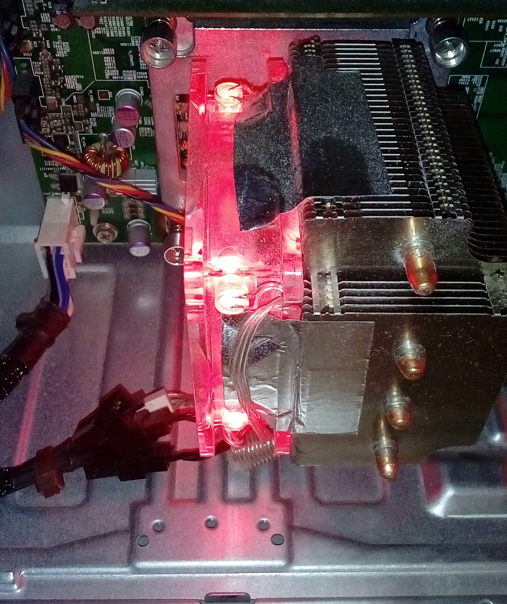

Has anyone tried to controll the fans on a fell t5500?
I'm upgrading my fans to pwm models and was curious if I should use one of the 5 pin headers, or just use molex/sata power?
Thank you

  2. Should I try and replace the stock CPU cooler with an aftermarket one?
    • A gentleman named Adam has a fantastic breakdown on how to replace a stock CPU cooler with a Noctua NH-D9DX i4 3U but I'm not sure if it's necessary (although I have a sneaking suspicion that it will be to keep the noise and temps down).
    • Secondary to this question, should I go ahead and get a second Noctua fan to add to the cooler or just keep it at one?
This is totally your call. I would refrain as the stock coolers for your system are very good, but that's me.

Is there a way to have the OS dynamically change the fan speed on the stock cooler so that it's not a choice between "set it and hope for the best" or nothing?
What would you say is a great price for the 2667's, 1680's, 1660's, or 1650's? Also, which might be the best option based on the work-loads described above. (Side note: how do people here feel about ES CPUs for use?)
Also also, for those who may be wondering, a T3600 system *will* take a 1300W PSU in the event that you might need that much power.
Jul 5, 2013
28,691 (6.80/day)
Not in the bios. However there are two options open to you.
First, you can get a third party fan(moving the Dell fan to another location but leaving it connected) and mount it to the CPU heatsink. This is what I do in two of my T3500's see image below. The upside is that the fan will always be running full speed(unless you buy an inline speed control), but the down side is it's always running full speed. For me the noise isn't a big deal as the fans are not very loud. So if you buy fans that are quiet, running them will not be a problem.
Second, you can look for a utility called SpeedFan. No promises it can find and control the fan controller in that system but it's worth a try.
I tried using Speedfan as well as HWinfo but for some reason the fan controller just doesn't show up. The only other option seems to be to just go into the BIOS and manually crank up the minimum speed setting under the auto settings for now (which isn't optimal). Have you heard of anyone being able to adjust something, whether by using a custom BIOS mod or any other way, so that a software program can control the fans manually? I had a similar issue with the T3600. Using HWinfo I could only set it at either 0, 1000, or 4K which was also not optimal.
