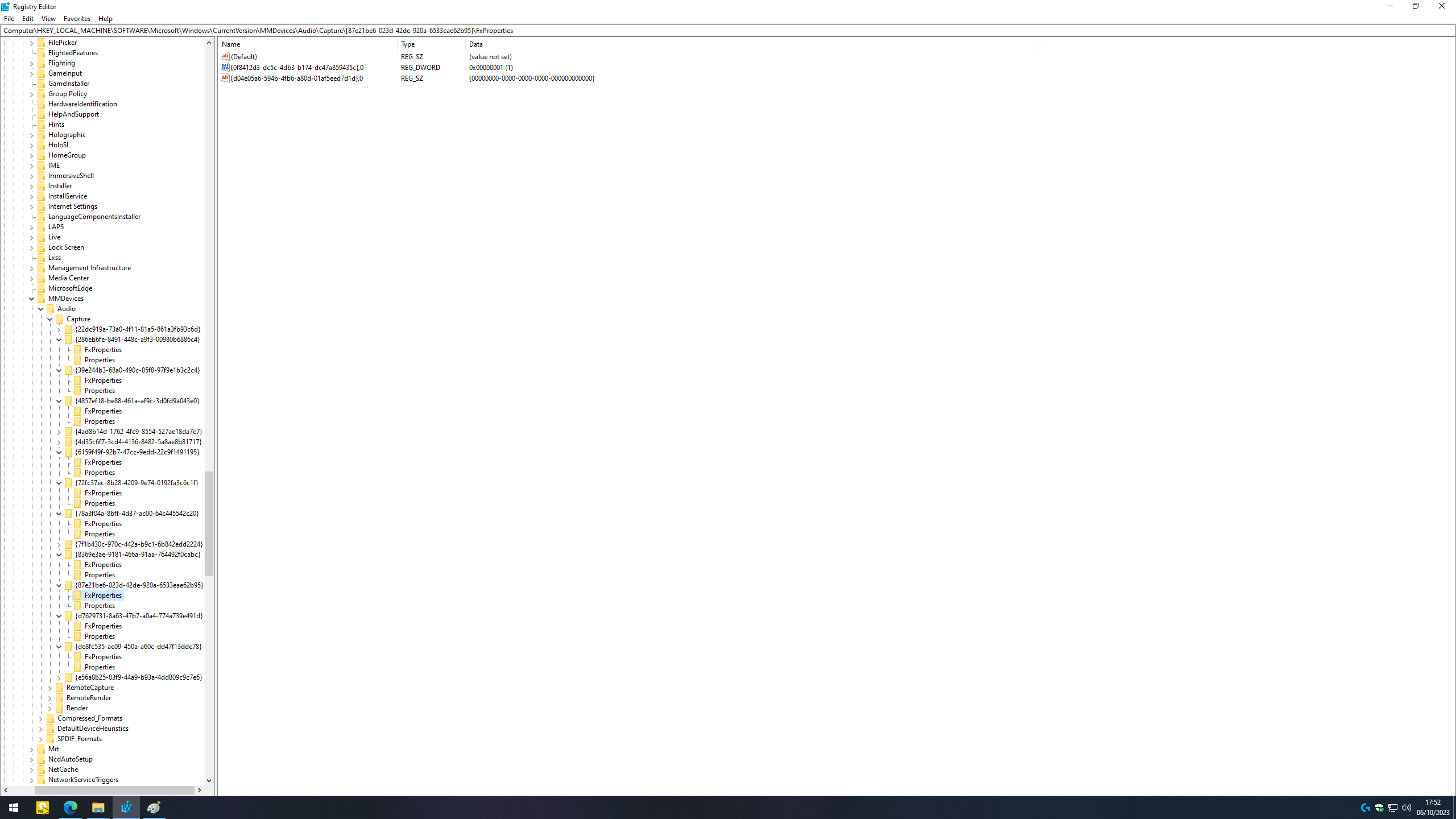

Optional:
So I found something that's due to Realtek, and in part due to the way they have done the ALC hardware. The driver files (not the inf) clone the registry data for speakers to certain capture points.
On paper that sounds fine, given the way the ALC is fitted to work, however, a render APO and a capture APO can be very different, and the codes used different.
I looked into the inf file to see if I am able to separate the data used on the capture points, away from the data used for speakers-headphones (including apos), but I can not.
It seems to be setup outside of the inf file, and as written above, it uses the data entries for speakers-headphones as the data for the capture points.
I personally removed the render APO's and DTS processing key (intended for render devices) from each capture point in the registry (9 in total, 10 including 'Stereo Mix' - personal).
Note that 'Microphone(s)', 'Line in' and 'Stereo Mix' are setup with capture APO's and do not need editing (except 'Stereo Mix', I prefer raw: DAC > no change).
I have attached a registry file with 10 entries (you need to fill out DEVICE-ID), right click the entry key in Regedit, rename, copy text, replace DEVICE-ID.
HKEY_LOCAL_MACHINE\SOFTWARE\Microsoft\Windows\CurrentVersion\MMDevices\Audio\Capture
The endpoints will works as normal, essentially in raw mode (which they should be given its after the DAC), only MS hidden APO's.
Anyone who wants to know the best ALC for SPDIF, 1st place would be 1220 VB, as it has form factor 'Speakers' (DTS APO4), and FR-RR instead of 1-6 in the mixer.
If you are using the DTS EQ, or bass boost, if you take it to a certain level, and hear distortion, its because the amplitude is too much for 24 bit (~144.5dB).
It seems the DTS APO4, APO's, are using 24 bit processing, opposed to 32 bit float, where it can amplify then attenuate without any loss.
One benefit to using 24 bit over 32 bit float is lower overall load, but its not worth factoring in, not even with a mobile CPU.
Note: If you are building an APO, use 32 bit float processing, making clipping-distortion impossible, simply attenuate or fix a maximum amplitude.
A fixed amplitude would mean I am able to raise an EQ bar further, but no additional amplification occurs due to the final bit depth.

With analogue, that is indeed very odd. You had this issue with official drivers previously?
With analoge I had no problems but couldnt get 5.1 DTS and 5.1 Dolby to work. All problems with crackling were exclusive to optical cable usage with DTS or Dolby. Tried a bunch of custom drivers. With official driver I cant get 5.1 DTS & Dolby at all
Dec 8, 2020
3,051 (2.05/day)
United Kingdom
Oh optical, though for some reason you meant you where getting crackling with analogue, sorry. Yes the start-stop pop is a problem, although it does depends on the receiver.
I can have 'Stereo Mix' off and not get start-stop noise, and then with some other apps, I do. It's do to with stream response time and hardware I guess.
My fathers older Samsung TV will do DTS - Dolby encoding like the driver, it does the same 'always on' stream (no popping so on).
It seems to be that removing the render APO's from the hardware capture (loopback) to stereo mix, fixed some issues, 'so far' no listen to bug, or cut out on startup.
I do know that sometimes if the bug was to occur, any APO programmed to the effected point(s) can end up bugged and degraded, really badly.
This issue is an issue that needs to be fixed by Realtek (without my after fix), I might be able to input manual entries, but I think the driver will override them.
Currently I am not sure of the names for the entries, although it may be the same names as the ones that are added to the registry.
Ideally Realtek should supply separate entry points in the driver .inf file to prevent crossover of render APO's on a hardware capture point.
The situation could be worse if I was using render offload in the .inf, as the APO's would be present on the capture points.
'Realtek Capture.reg' added to 'DTS Settings', its a single entry version, copy the text as many times as needed then edit the GUID's, alternatively manually edit the registry.
I will update the Realtek files once this has been addressed, else not much point really!
