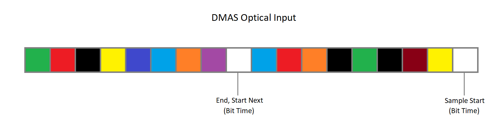

Here is a simplified multichannel RGB Optical input, each channel bit is pulled from the sample, and routed directly to the relevant speaker as one stream.
In this example, white and off are reserved, off means no data (0 volts), white is the sample packet (not sent to any speaker).
This example is two samples of 8 channels, 18 total bits sent.
No specific set channel, bit depth or sample rate limits set by RGB Optical, its limited by bandwidth and-or processing ability.
The bit depth can go as high as the number of colours available (ex reserved), 256 colours = 256 bit.
