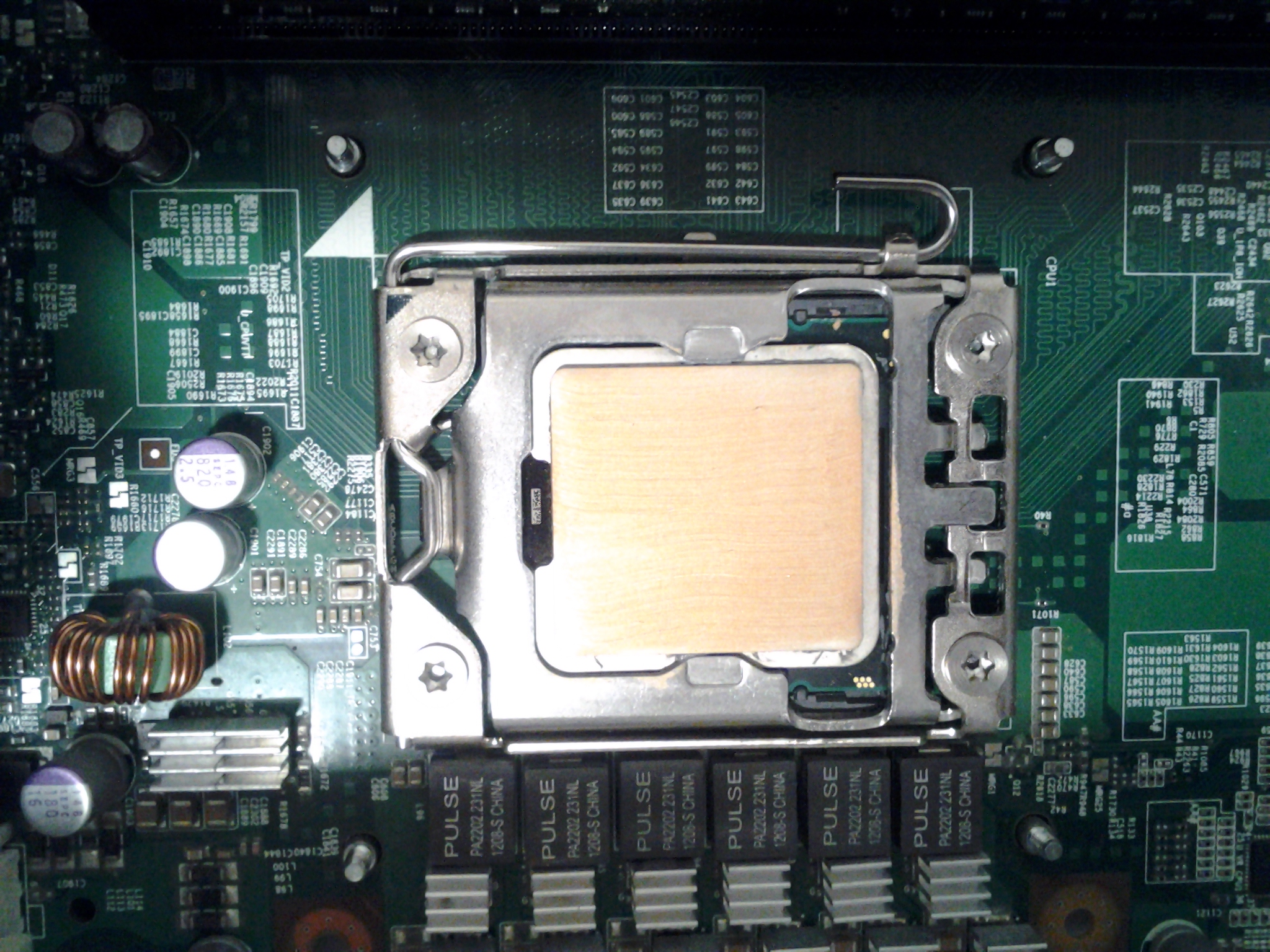

Ok folks, testing is done.
Let's state the particulars.
The system being used is a Dell Precision T3500 with an Intel Xeon W3680 using the stock cooler and a steady state 3700RPM 92mm fan. The testing software was Prime95. Temp monitoring software is HWInfo. The thermal interface materials being tested are as follows:
Dragon Star DRG102, compound very similar to Arctic Silver 5
Automotive Copper thread grease
Noctua NT-H1
Arctic Cooling MX-5
The tests were conducted as follows:
3 runs of 2 stages of Prime95 calculations which run for a little over 11 minutes per each TIM.
Here is how each was applied. I did not take photos of the Noctua NT-H1 as I forgot to. It didn't look any different than the DRG102.
DRG102
View attachment 202525View attachment 202526
Copper Grease
View attachment 202527View attachment 202528
MX-5
View attachment 202529View attachment 202530
As you can see, I spread the TIM out in very thin layers. The DRG102 and Copper Grease were the easiest to spread evenly. NT-H1 was a little more difficult but only a bit. MX-5 was a bit of challenge but with a few minutes of work it spread out fine. It is as "sticky" as everyone claims of course, however this is a minor thing.

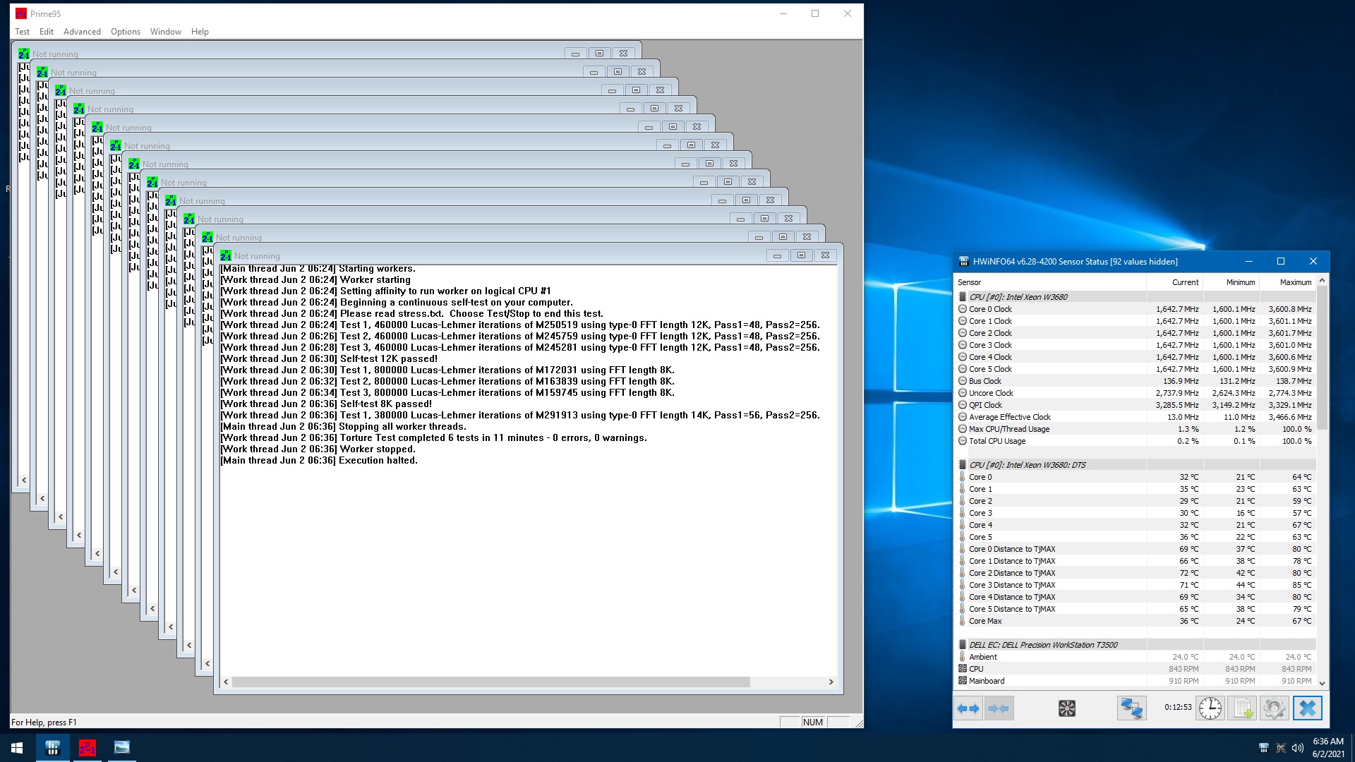

Here are the test results.
Dragon Star DRG102
This performance ranks third best in the tests.
Automotive Cooper thread grease
This performance ranks fourth in the tests.
Noctua NT-H1
This performance was second best in the tests.
Arctic Cooling MX-5
This performance was the best of the tests.
My conclusion is that MX-5 is a very impressive TIM. It bested NT-H1 by several degrees C in both idle and full load tests. It also bested the DRG102 handily. The copper grease proved inferior to the rest, even though the temps were within reason as expected given that the compound was used in this same system for nearly a year and performed well. NT-H1 is widely regarded as a premium TIM and has shown itself to be an excellent performer. For MX-5 to perform better than such shows it to be, at the very least, competitive with premium TIM's and at most superior to many of the of the top shelf brand TIMs.
The screenshots are here for you all to draw your own conclusions though.
