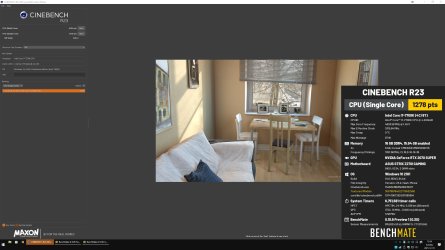

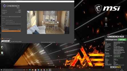

Here
You have a 8700k vs 6700K and in some cases, the performance for the 6700K dips not to mention the lows are much lower vs 8700K. Obviously, it is with some games not all but it is, in my opinion, worth mentioning. Especially if you consider that games become more demanding. Also, these benchmarks were conducted with a GTX 1080 which isn't overwhelmingly fast but still.

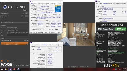

now i'm using a 4770k @ 4,6ghz + 2400mhz ram it run fine with a 6700xt at 1440p 80hz the fps around 8x-9x fps which is great for my case ....as much as cinebench single score from haswell to comet lake the score when overclock around 12xx so ima say they're around same level. for 1080p 144hz gaming i think the 4c/8t is kinda not enough i would recommend smth like 12600k ......
