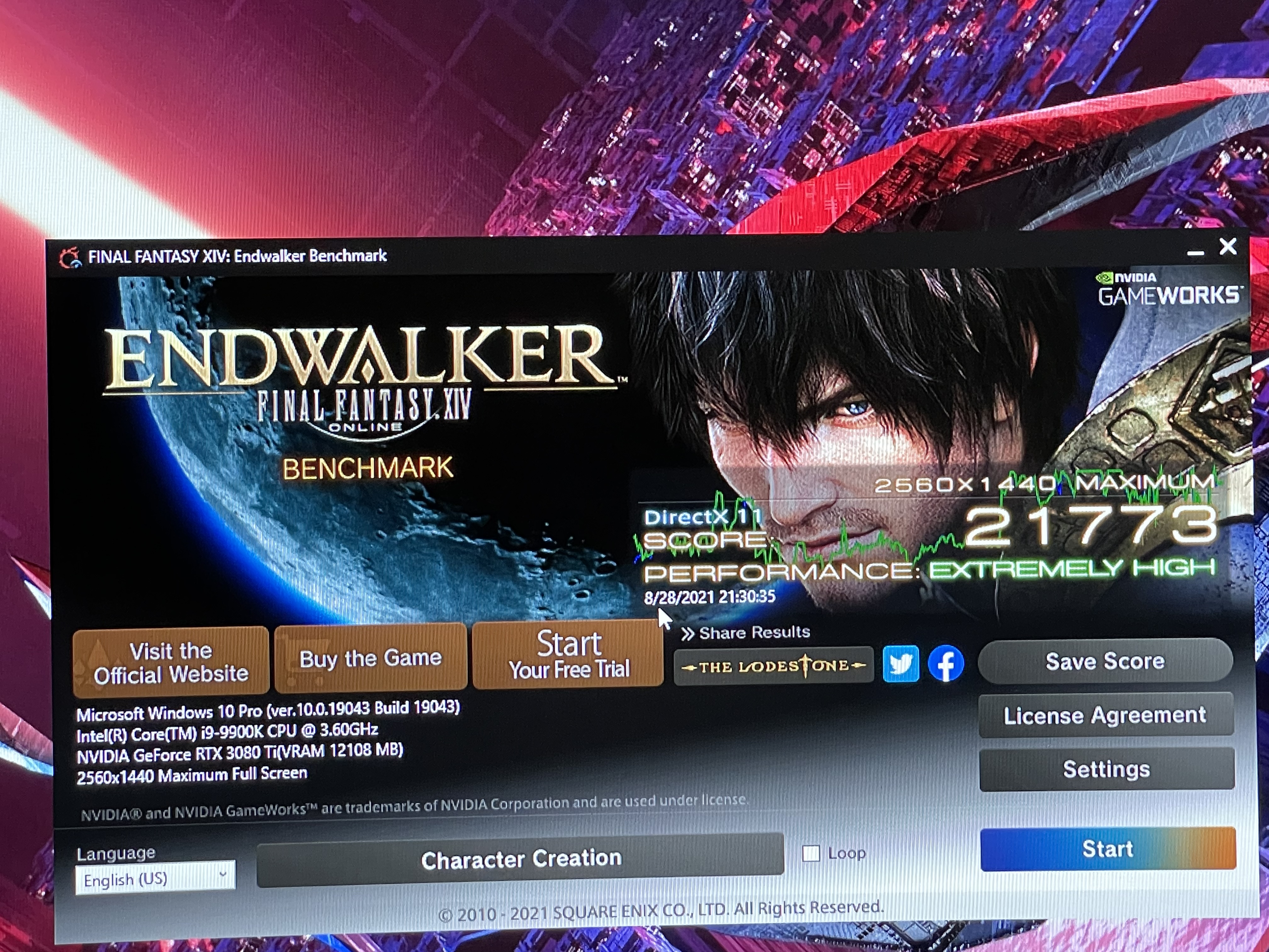

Not sure but that look like PSU problem....You should try some other really heavy GPU benchmark and see if that happens again.....
Thanks for the reply. Can you suggest a really good GPU benchmark? I tried 3D mark and my GPU was fine.

Ok. I did more tests. I ran heaven benchmark, furmark (3mins), timespy stress test(20 mins). No issues. I re-dl endwalker benchmark and the problem is still there. Seems like im only having issue with the endwalker benchmark. Is it possible that the endwalker benchmark is the most demanding test out of all?Ill try ur combo suggestion. I really appreciate your help.
p.s. i was able to run endwalker benchmark the first few tries when i first swapped my gpu. But when i changed the aettings from maximum to high, thats when i started having problems.

Ok. I did more tests. I ran heaven benchmark, furmark (3mins), timespy stress test(20 mins). No issues after all those. I re-dl endwalker benchmark and the problem is still there. Seems like im only having issue with the endwalker benchmark. Ill try ur combo suggestion. I really appreciate your help.
Your 3080 Ti is boosting to unstable clocks in this benchmark, set -45mhz on the core clock in MSI Afterburner and try again.

My bad, i was only able to finish my benchmark the very first time i swapped my gpu to 3089ti. The problem started to happen after changingmy settings from maximum to high. And it is still occuring now. Will try @nguyen suggestion when i get home
Update: I followed @nguyen 's suggestion(thank you for that) but i had to lower the core clock down more to -75 and i manage to finish benchmark with no issues at maximum settings a few times. But when i change the settings to high, the problem comes back. Does this mean that I have a defective card? Or is it an issue with my other pc components?
